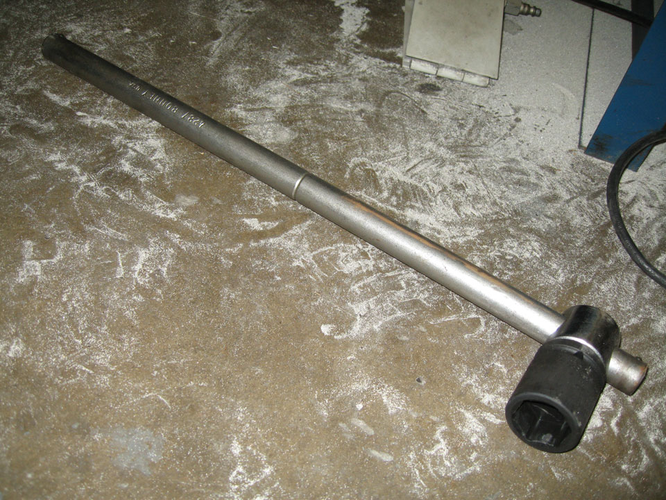

The big bolts at the rear are a bear. Oh, 3/4" Bonney! (IMG:style_emoticons/default/bootyshake.gif)
(IMG:http://www.914world.com/bbs2/uploads_offsite/www.914club.com-11782-1315102885.1.jpg)
After much liquid wrench.
(IMG:http://www.914world.com/bbs2/uploads_offsite/www.914club.com-11782-1315102885.2.jpg)
A giant release, a big pop and off she came. (IMG:style_emoticons/default/beer.gif)
