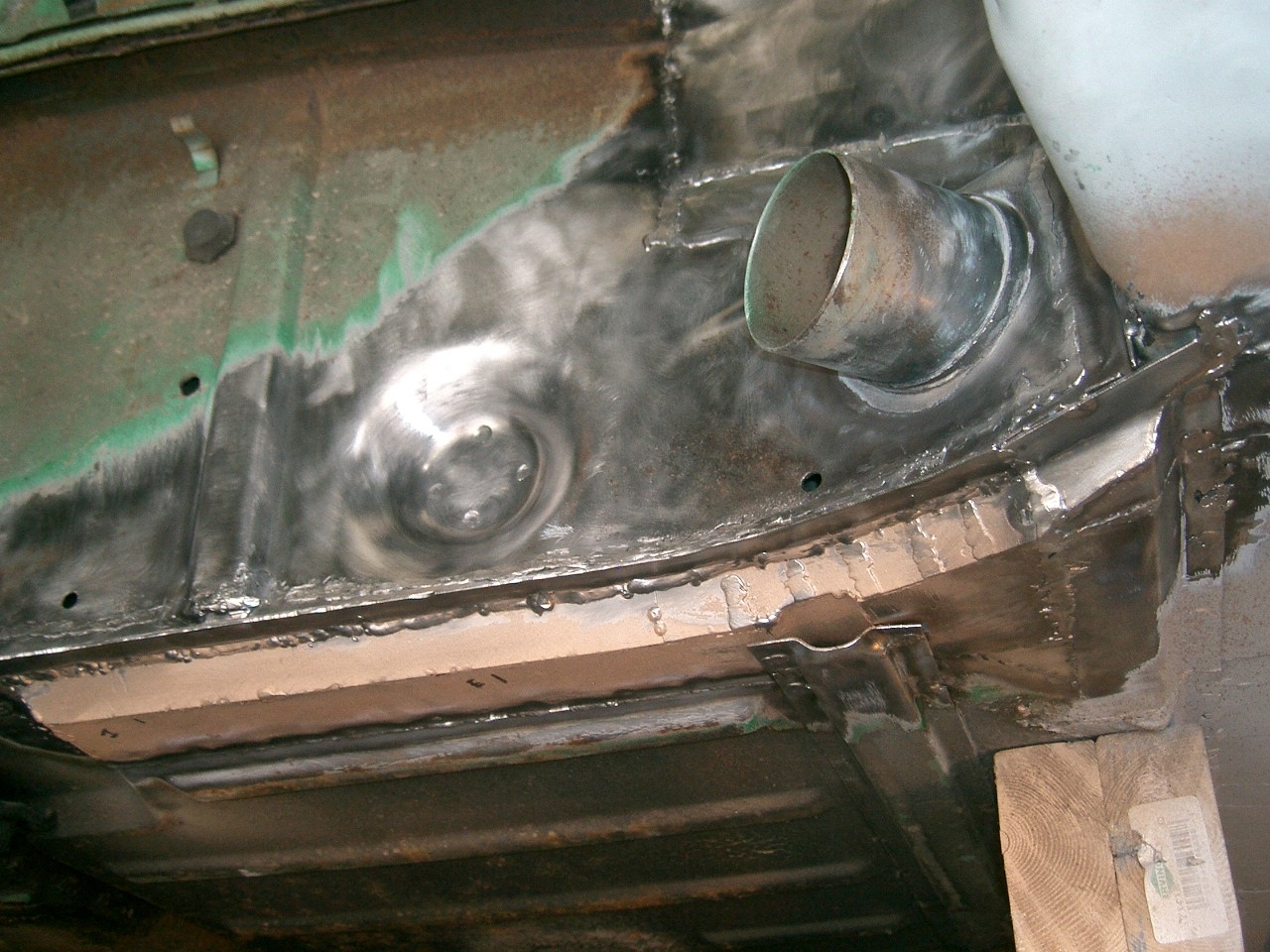

My welding skills have improved significantly, but it still seems like I spend a ton of time grinding...

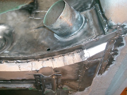

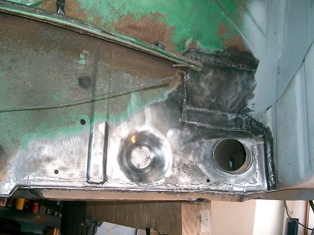

Tying the firewall, floorpan, and inner long together has been a challenge. Two small patch panels were fabricated and welded in where the outer firewall curves rearward to meet the inner long. Final piece welded into the floorpan where it meets the long. Took the wire wheel to the whole area to prep for a light Ospho treatment in one area and I hope to get this area primed tomorrow:

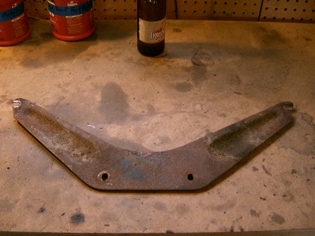

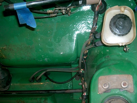

Tomas donated a used set of plastic MC lines to the cause as my originals were accidently strafed by a wire wheel. While the Ospho was drying, I installed them, taking any means possible not to disturb the new master cylinder. Thanks Tomas! Started cleaning up my rusty muffler bracket as well:

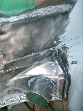

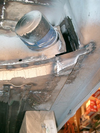

saigon71   Ended up with a bit of a mess where the floorpan m...   Jul 20 2011, 02:47 PM
saigon71   Outer firewall patch:   Jul 20 2011, 02:52 PM
saigon71   For the front firewall patch, I opted to make a te...   Jul 20 2011, 02:56 PM

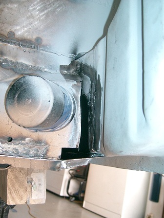

saigon71   Welded in the lower inner vertical firewall piece:...   Aug 2 2011, 07:45 PM
