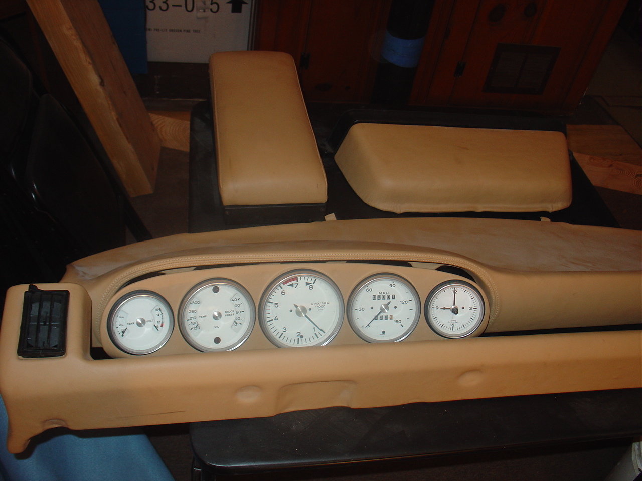

Here is a photo of the gauges that north hollywood speedo did 10 years ago and then were set on the shelf until 6 months ago when they had to redo the speedo again for the electronic speedo and then the tac to add the boost gauge. The temp had to be changed to water from oil and also the oil tank level was changed to a voltage gauge.
This should be the final configuration.

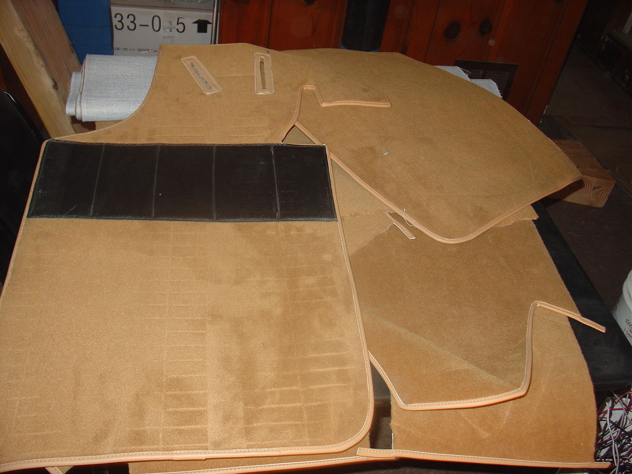

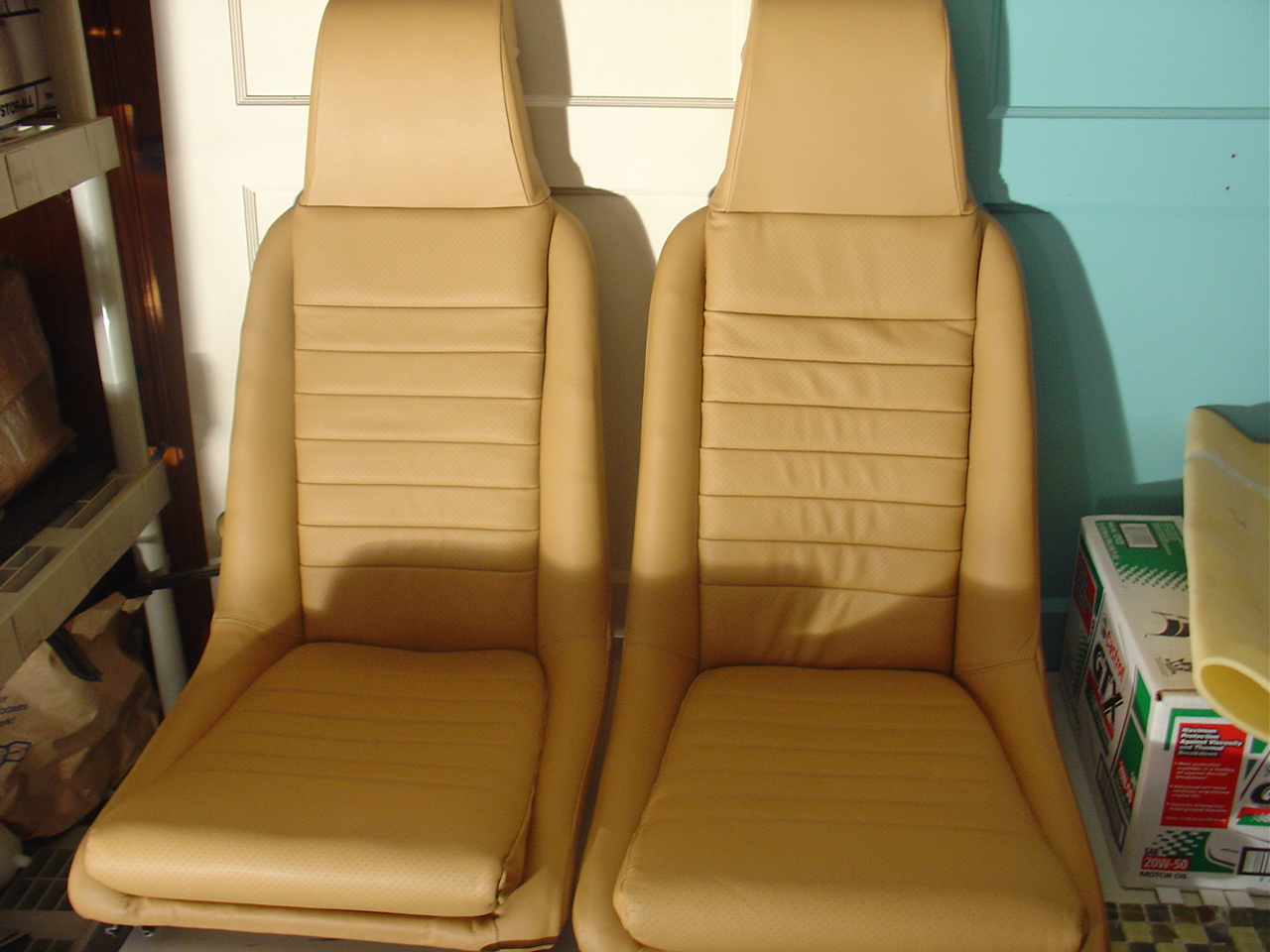

The interior was done in tan leather and wool carpet about 10 years ago. Maybe will finally be installed this year.

rohar   Oh, and the redline on your tach seems a bit low a...   Sep 5 2011, 05:32 PM
Chris Scott   We realized the deficiencies in the gauges also bu...   Sep 5 2011, 05:39 PM
