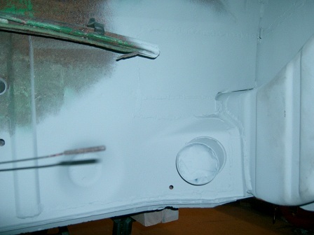

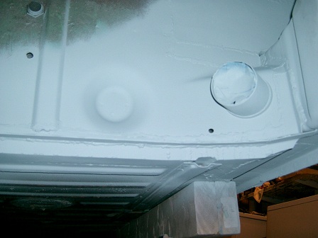

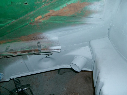

Shot two coats of primer on the rebuilt pass side firewall/floor pan. It was a lot of patchwork, but I am pleased with how it all worked out. (IMG:style_emoticons/default/biggrin.gif)

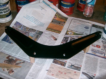

Cleaned, treated and painted the exhaust bracket.
