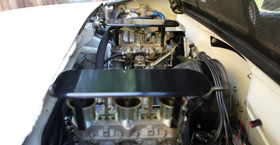

Just curious then:
Why was the 914-6 GT racing car sold with carbs?
AND won 1st place in GT class at 24 hours of LeMans in 1970?
(IMG:http://www.914world.com/bbs2/uploads_offsite/www.maxted-page.com-10819-1315333935.1.jpg)
Musta been because FI was better, but they wanted the challenge of racing with inferior equipment.....
Just ONE of the answers is:
Because the carbs give an expert infinite (almost) adjust-ability.
But with 70s technology FI, you get what you get.
Now if the Poll had mentioned modern FI like the megasquirts, the FI wins hands down.
The stock FI on the 914 is an analog computer. Unless you know how to change the gains on Op-Amps, then you cannot change much at all.
If you increase displacement or change the cam you are stuck.
Stu
