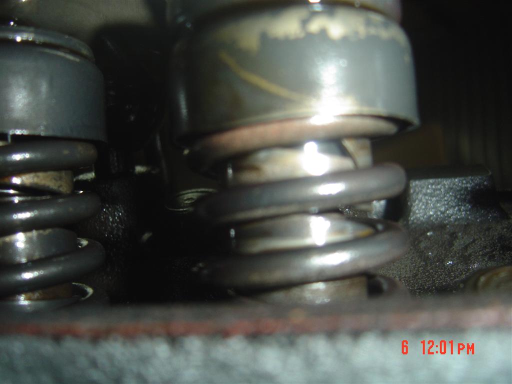

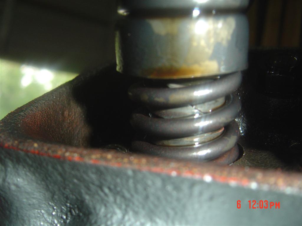

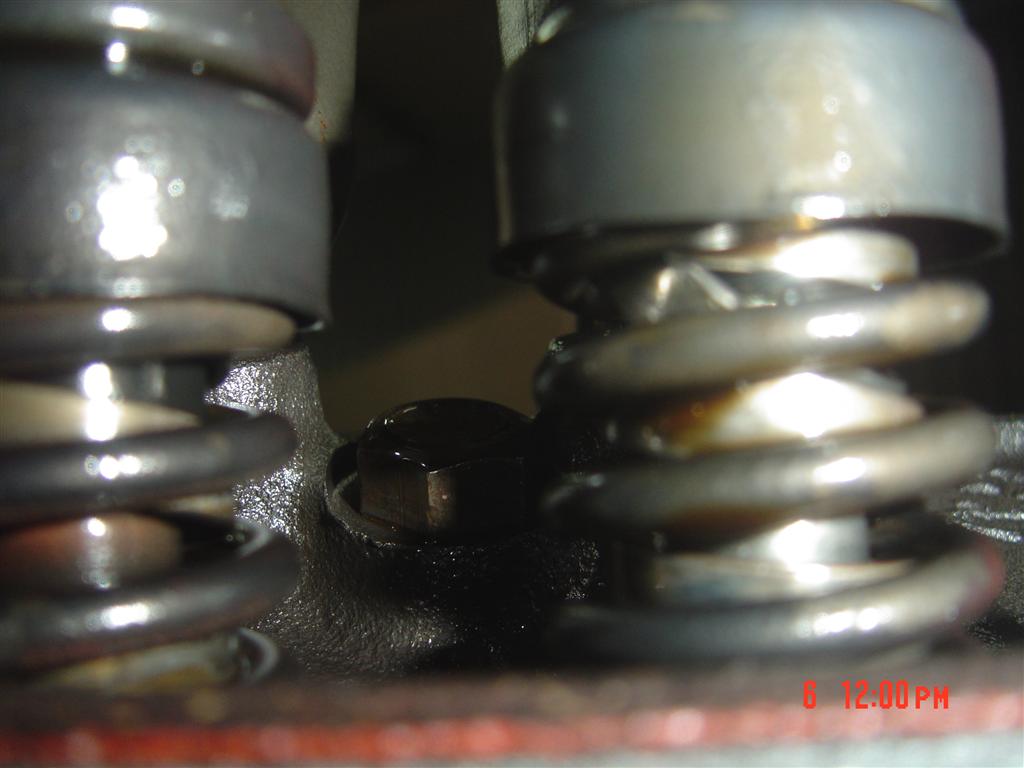

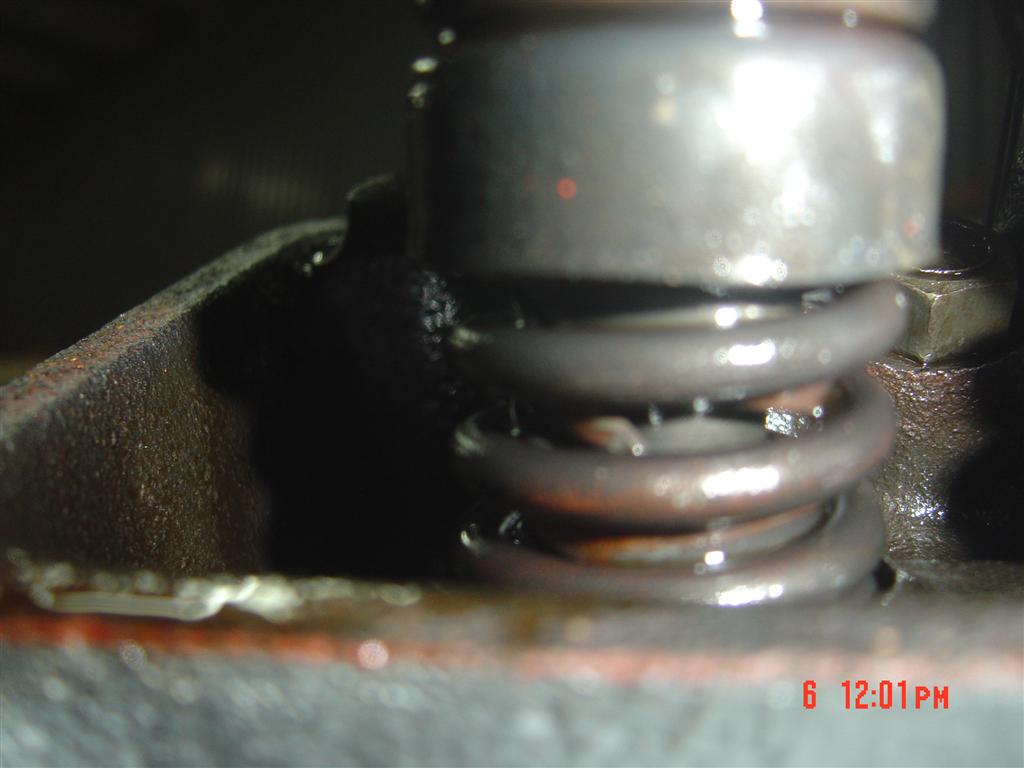

So onto the latest (IMG:style_emoticons/default/headbang.gif) EVERY oneof the inner valve springs on this engine is broken, most in multiplpe spots. I had a friend that builds race car engines come by and take a look at it. He said this is very common with the HCevy's that run a factory dual spring setup. The good news for Jim is the parts are fairly cheap, so I'll be replacing all of the springs, keepers, and caps, as well as the timing chain as it has a little play in it
