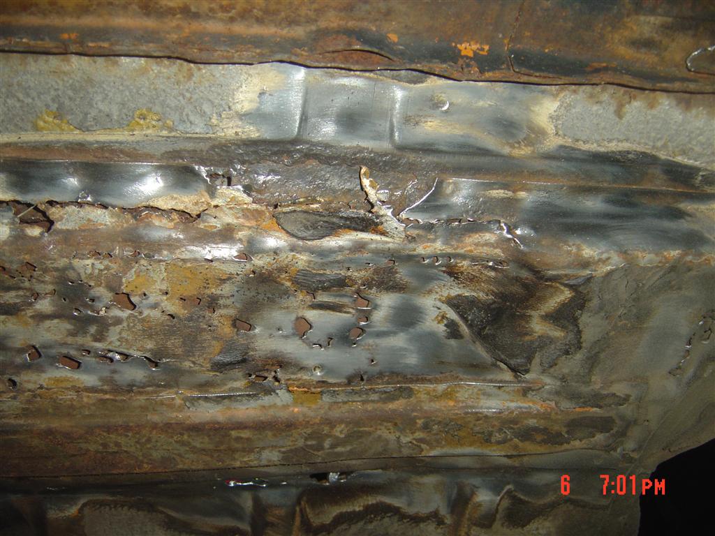

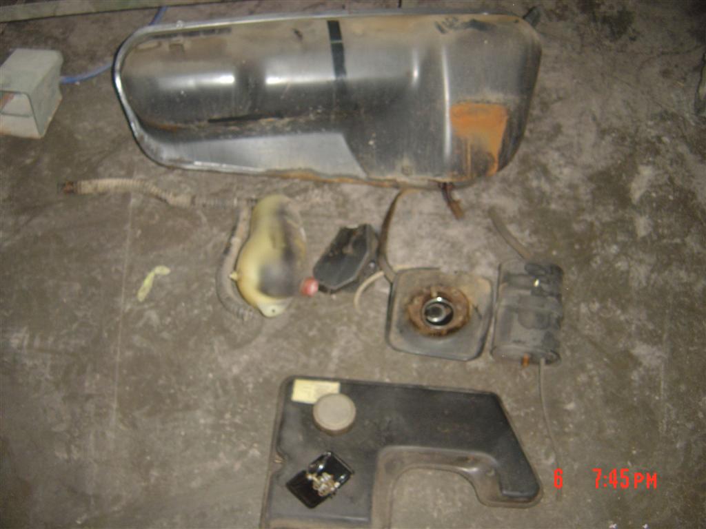

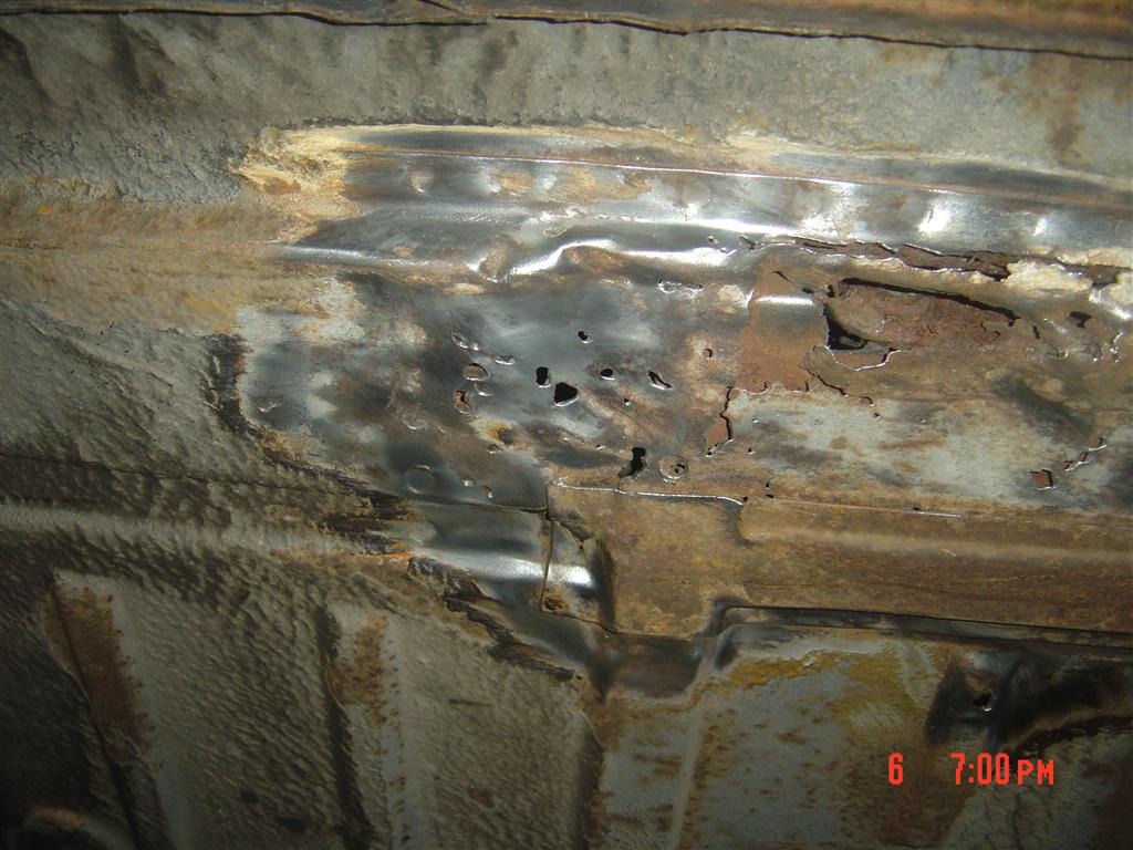

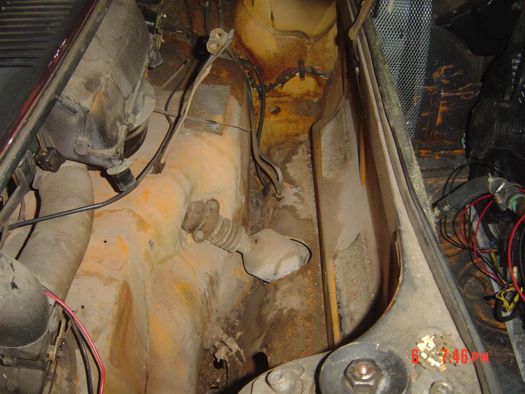

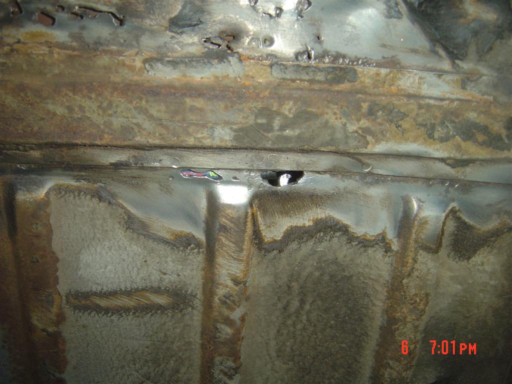

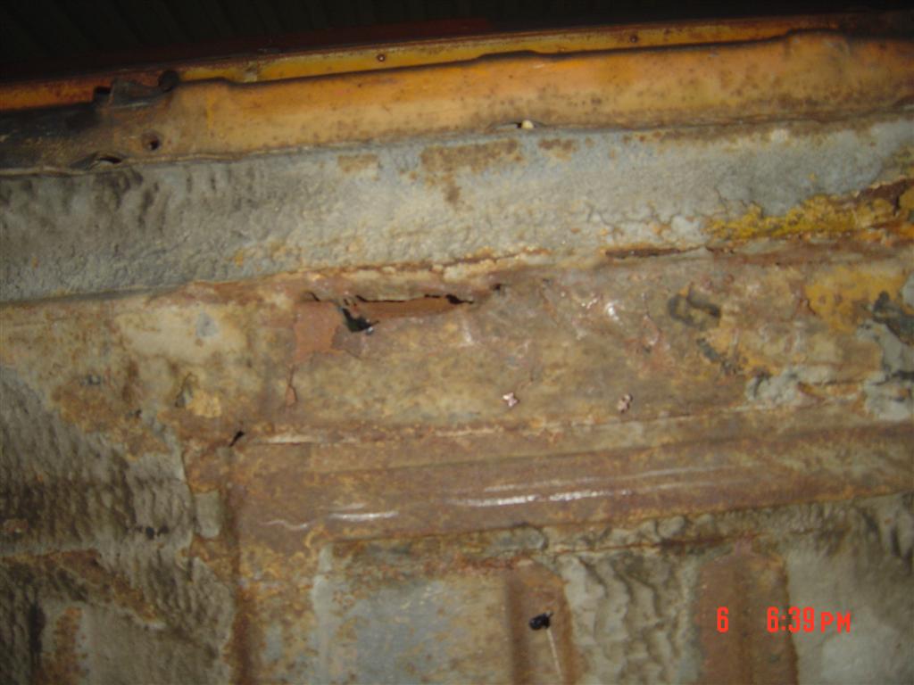

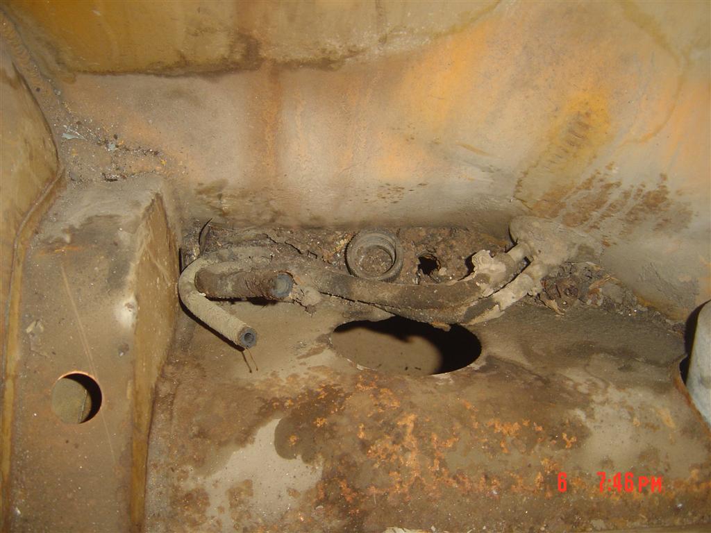

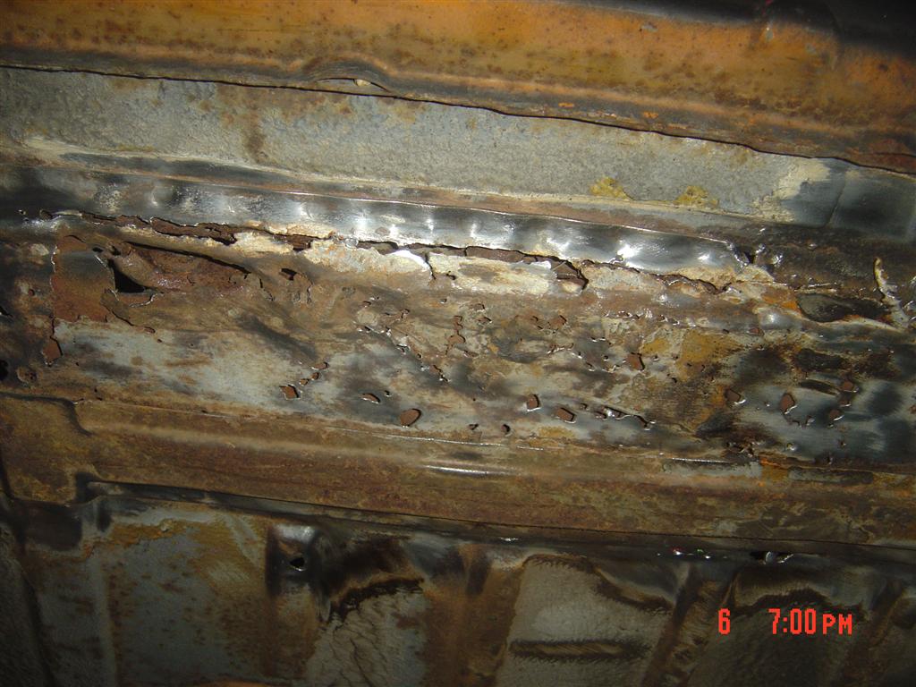

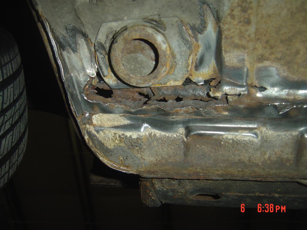

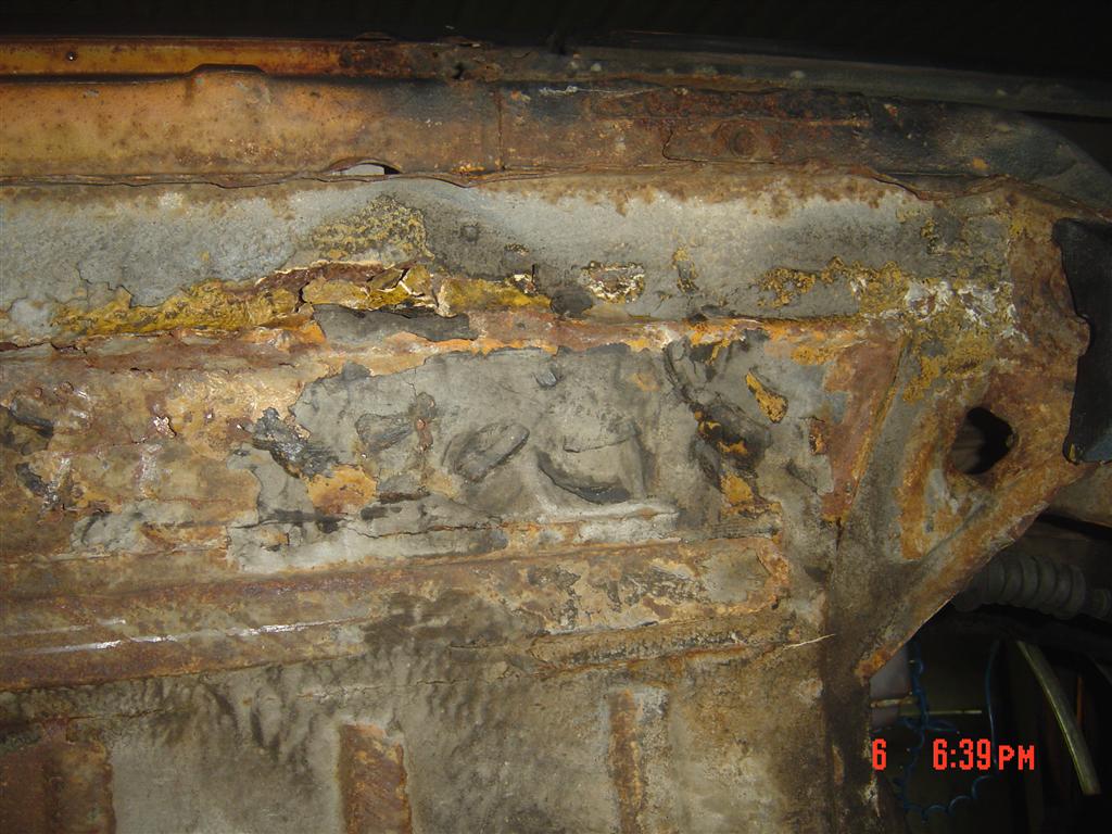

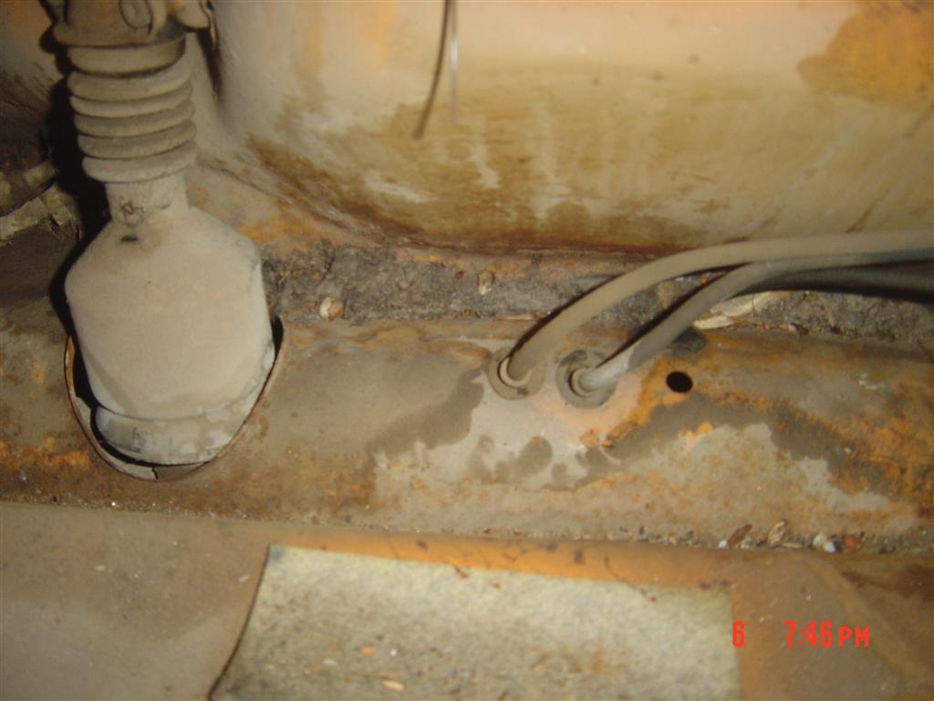

Drained the gas tank and pulled it. found Jim's washer bottle top (IMG:style_emoticons/default/av-943.gif) and looked into some rust issues we knew about to see how bad they were
See Mark, it isn't just your car (IMG:style_emoticons/default/poke.gif)

scotty b   So onto the latest :headbang: EVERY oneof the inn...   Sep 6 2011, 06:59 PM
scotty b   Drained the gas tank and pulled it. found Jim...   Sep 6 2011, 07:09 PM
mepstein   Drained the gas tank and pulled it. found Jim...   Sep 6 2011, 07:29 PM
messix   those aren't springs theyre dampers   Sep 6 2011, 07:09 PM
scotty b   those aren't springs theyre dampers potato,...   Sep 6 2011, 07:25 PM
jimkelly   not sure what i am looking at - it appears one are...   Sep 6 2011, 07:44 PM
