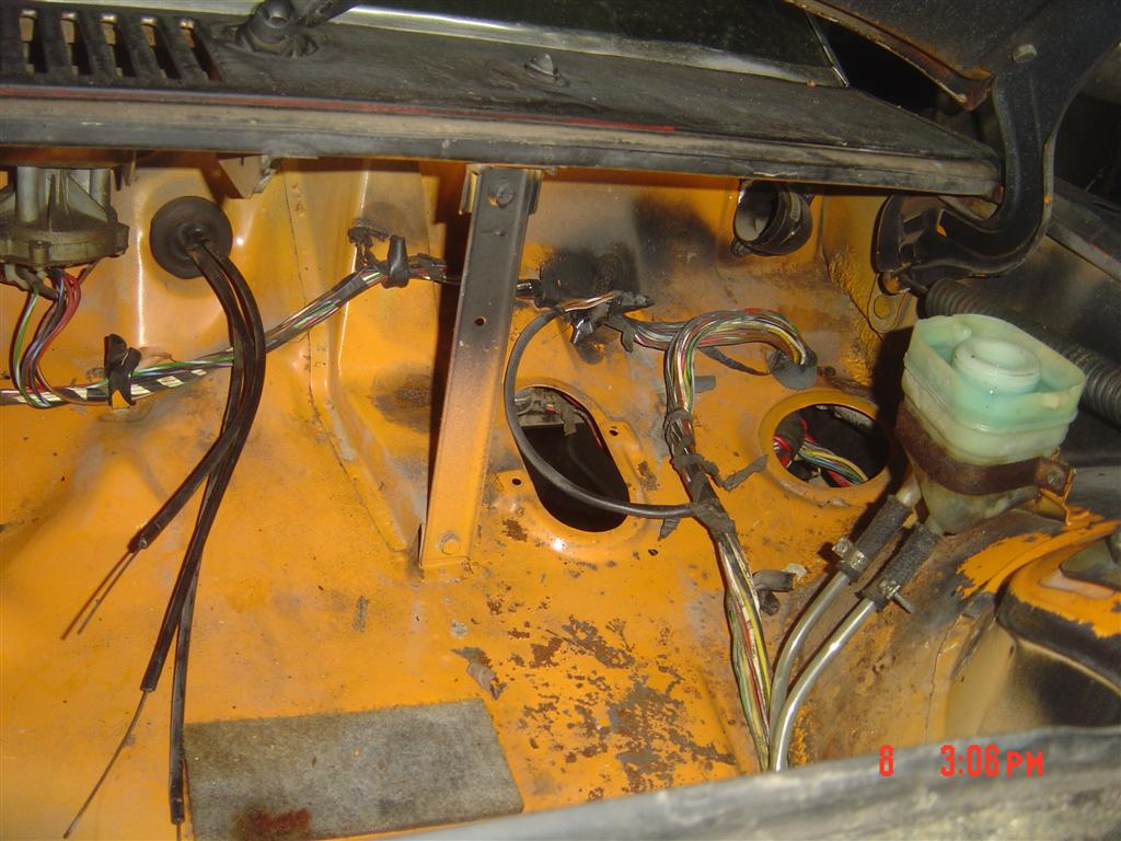

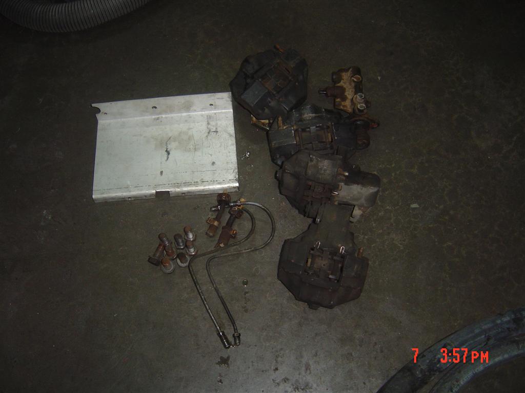

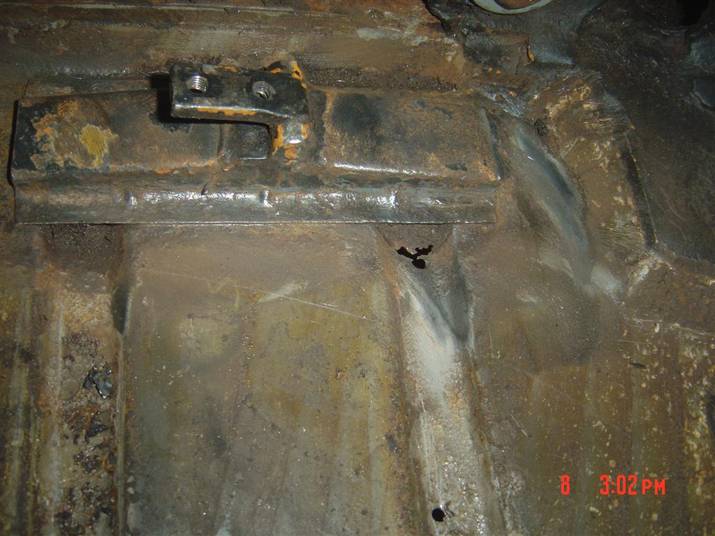

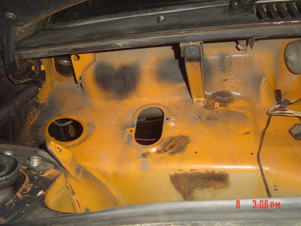

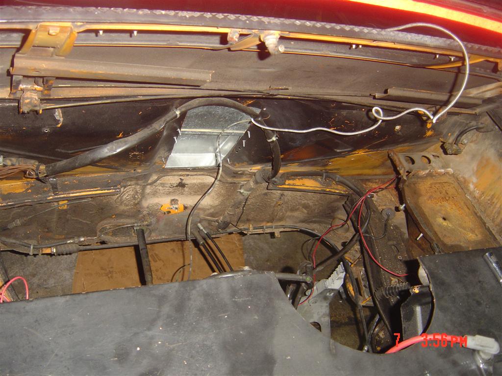

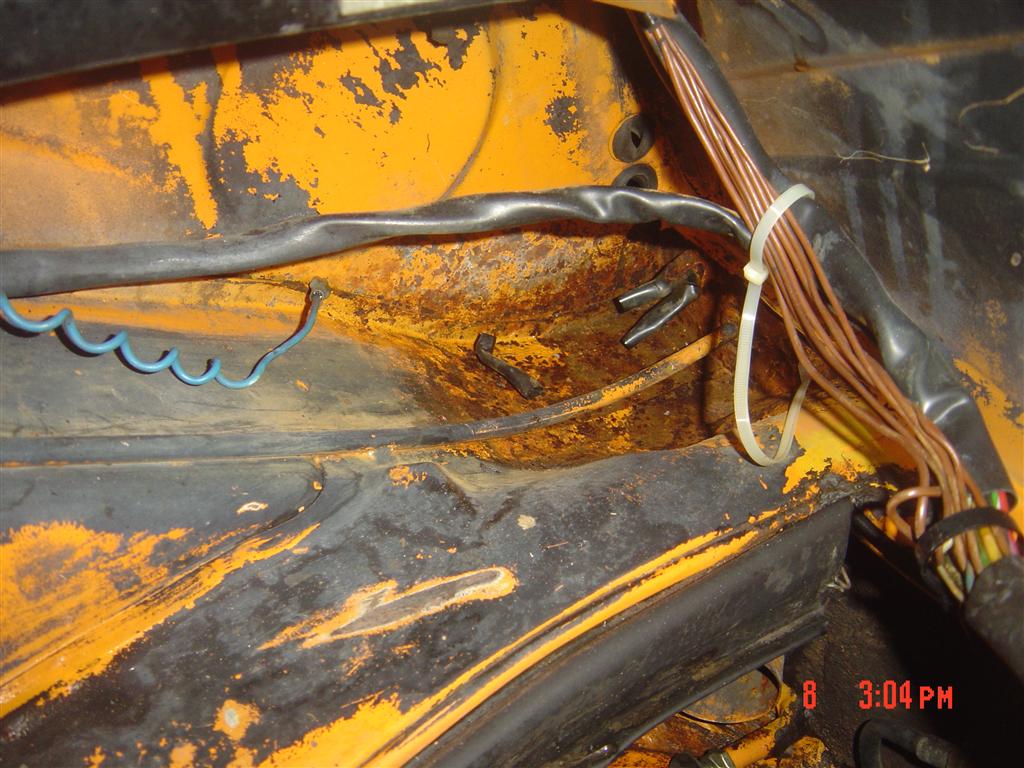

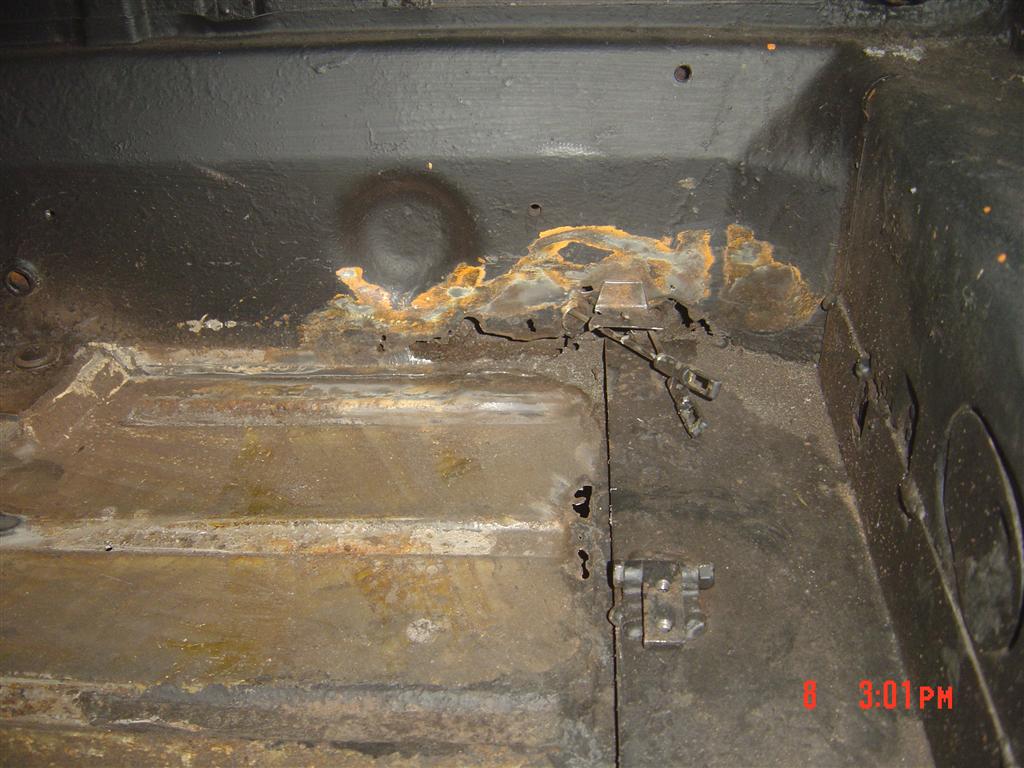

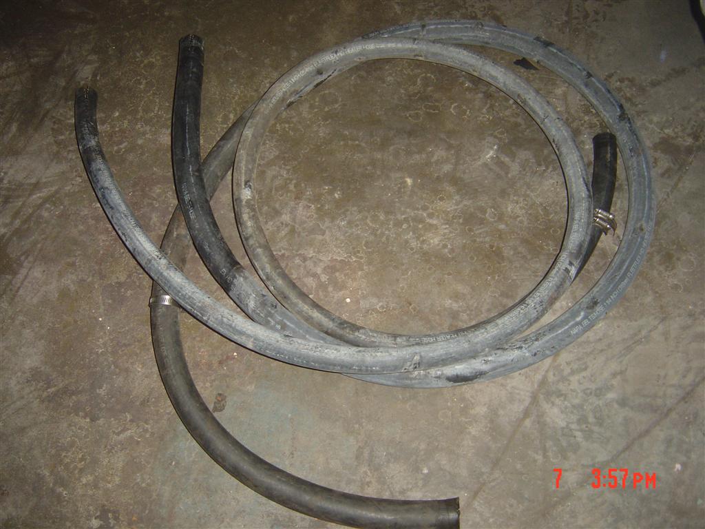

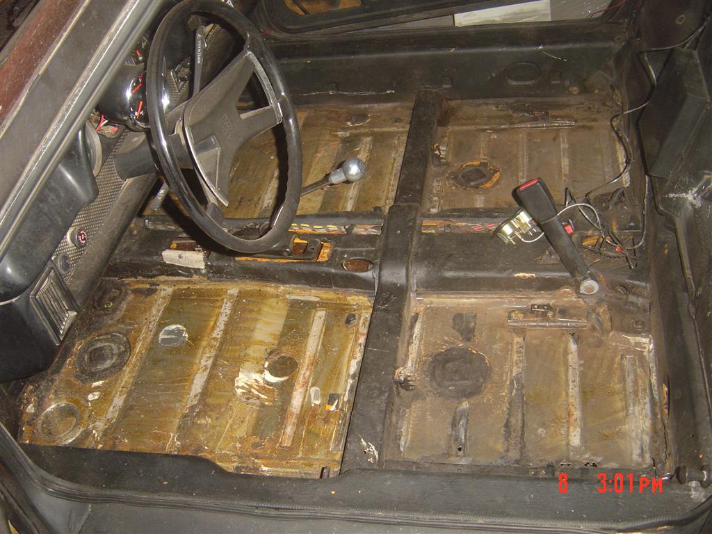

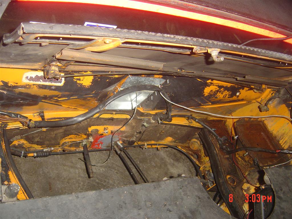

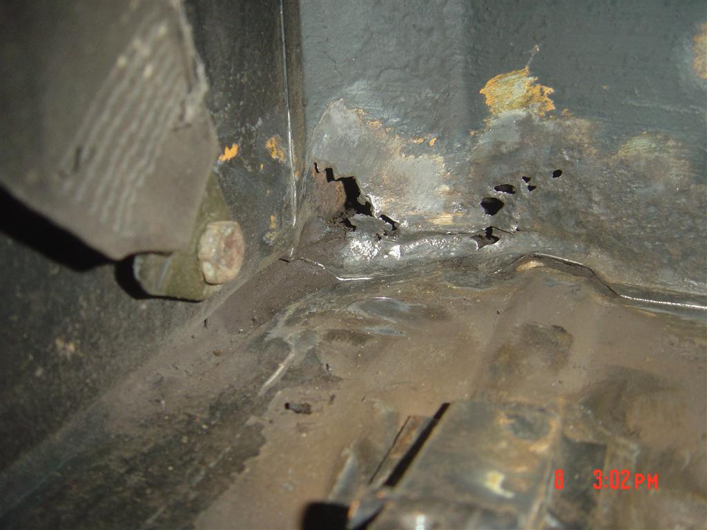

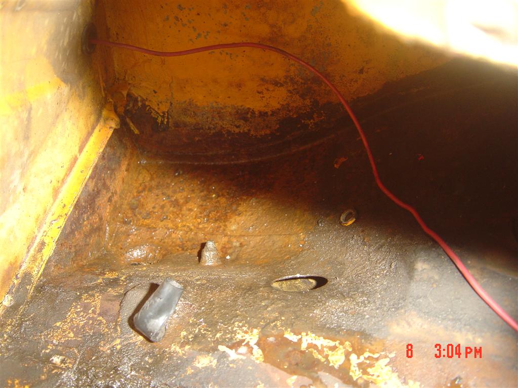

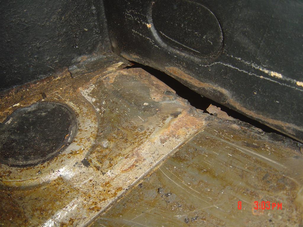

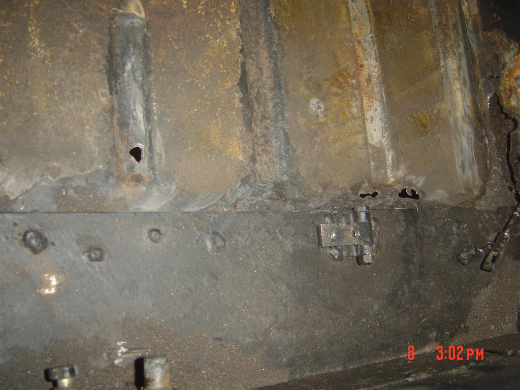

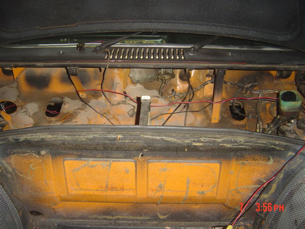

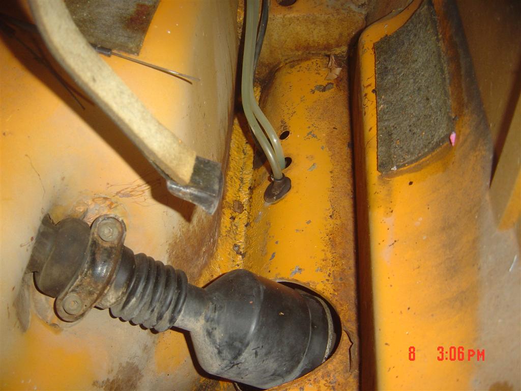

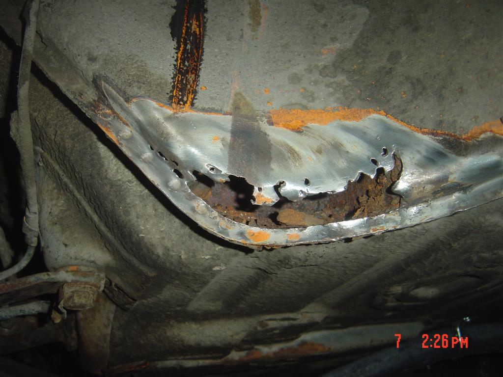

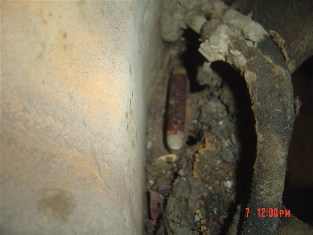

I found where O.J.'s knife went. (IMG:style_emoticons/default/unsure.gif) Removed the ventilation system, fuel system, cooling system and pretty much everything else that will be replaced or deleted. Popped out the seats, power washed the engine bay, underside ,and the front trunk. Removed the tar from the floor so we could see exactly what we have to deal with rust wise
