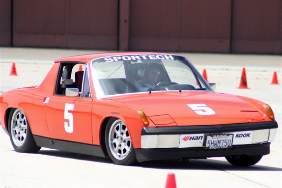

no budget for PRETTY and this time - so it will leave charles city as hideous as when it arrived : ))
i'm torn on color - stock signal orange is probably the right thing to do - but i like silver, black, and various shades of orange as well ???
when it is time for paint - i'll be also facing a big bill for all weather rubber as well, and maybe front and rear fiberglass bumpers.
at this moment - i am leaning towards this look ...
