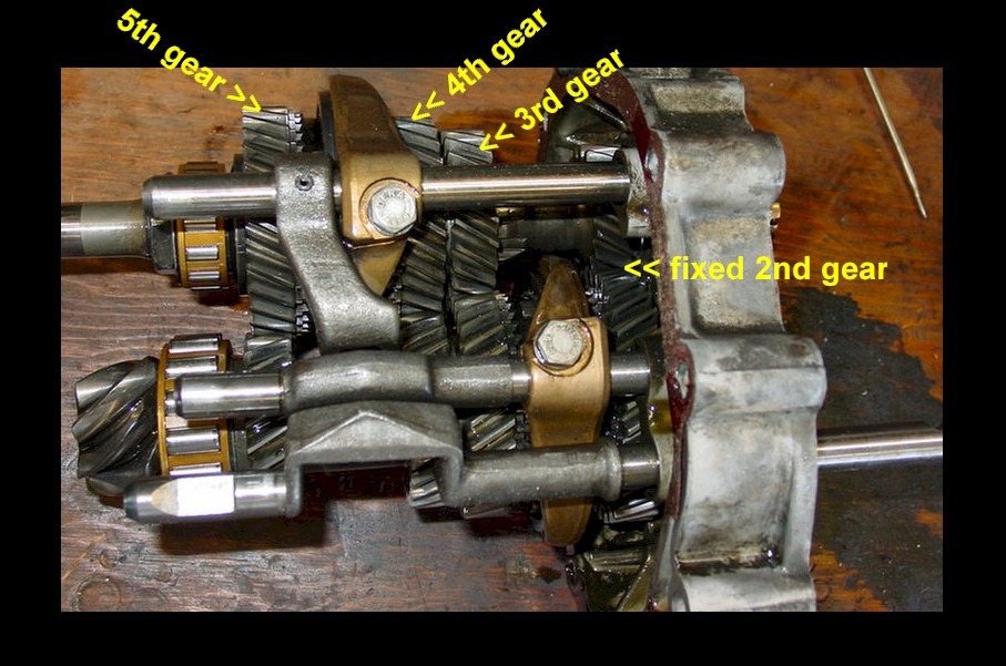

gear stack pic
my plan is to ...
delete 1st gear - block it off.
2nd = stock F
3rd = flipped V ( equal to using an R )
4th = ZD ( move ZD from 5th to 4th position )
5th = H flipped ( as overdrive )

jimkelly   gear stack pic my plan is to ... delete 1st gear...   Sep 15 2011, 07:25 AM
computers4kids   gear stack pic my plan is to ... delete 1st gea...   Sep 15 2011, 08:08 AM
