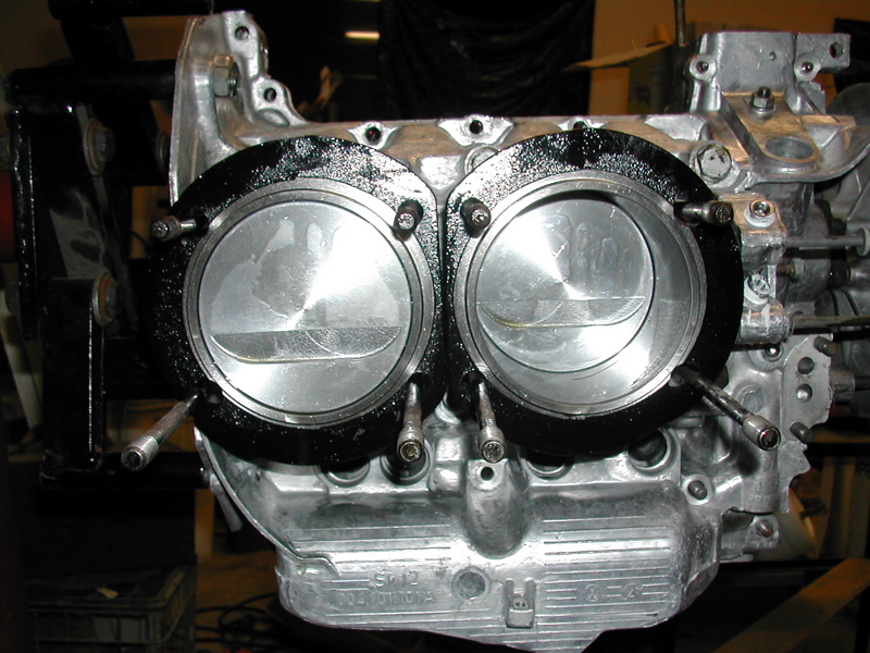

Well, anyone who's used them? Does the arrow point up or down?

The piston industry standard is to make a mark that points to the flywheel. Are these the pistons with the valve relief pocket? If so, the pocket does DOWN, regardless of anything else.

BMXerror   No, they're basically 1.7 Euro stockers, but t...   May 3 2008, 10:05 PM
SLITS   Are there any other markings on the piston crowns?   May 3 2008, 10:13 PM
brer   pics?   May 4 2008, 11:34 AM
BMXerror   pics? Only the mystery arrow and a number (89.95...   May 4 2008, 12:22 PM
Headrage   Look inside the pistons and see if there is a litt...   May 4 2008, 11:55 AM
BMXerror   Pic. Mark D.   May 4 2008, 12:26 PM
brer   only AA can help you me thinks. :confused:   May 4 2008, 09:18 PM
tod914   Is it possible the arrows where removed and put on...   May 5 2008, 01:05 AM
hot_shoe914   Here is my question. If the pushrods are on the bo...   Sep 22 2011, 03:24 PM
Dr Evil   The arrows above point up and down. That is not th...   Sep 22 2011, 10:02 PM
draganc   The arrows above point up and down. That is not t...   Sep 23 2011, 03:47 PM
biggy72   I know the arrow always points toward the exhaust ...   Sep 23 2011, 12:17 AM
Dr Evil   Yes, one would have to flip the pistons to point a...   Sep 23 2011, 04:12 PM
Series9   I'm looking forward to this answer. I've ...   Sep 23 2011, 06:22 PM
r_towle   measure the wrist pin placement to see if it is ce...   Sep 23 2011, 06:42 PM
Krieger   On a map arrows point to North. On pistons they p...   Sep 23 2011, 07:09 PM
hot_shoe914   Well, I don't know about the arrows other than...   Sep 24 2011, 07:03 AM
