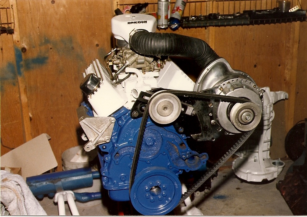

Sorry guys not a T4 but here is a picture of a Paxton Blower I put on a Ford V-6 which went into my first 914. It was originally from a Studebaker. It worked well on the 2600cc V6, I modifided it several times eventually adding an intercooler. Blowers definetly add low end torque, no turbo lag!!!
