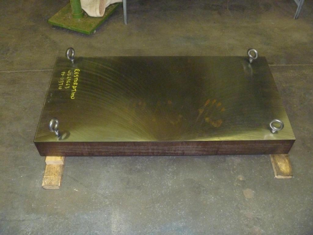

Alright, I spoke a while back that I was going to start producing the Front trunk pan. I already have all the steel and all the CAD work done, so all I need to do is prep the steel and start cutting!
I wanted to start a thread here for all to follow the progress and also to get a better idea of what goes on at Restoration Design. I am the one in charge of designing and making all the dies here for the 914, 911, 912, and 356's. I have only made two small dies( pedal cluster support, seat mount bracket) for the 914 so far so I wanted to make something else that was in need.
I started with an NOS full floor pan. The one that runs from the firewall all the way to the front trunk pan. Brought that away to get a digital scan and then from there I designed the male and female halves of the die.

peteyd   Did some prep work on the blocks of steal so I can...   Sep 28 2011, 10:28 AM
peteyd   Now I can move them onto the mill and drill and po...   Sep 28 2011, 10:29 AM

peteyd   Loading the steal... I have to clean up an ed...   Sep 30 2011, 10:39 AM

peteyd   Got some work done yesterday, and set the steel up...   Oct 6 2011, 01:31 PM

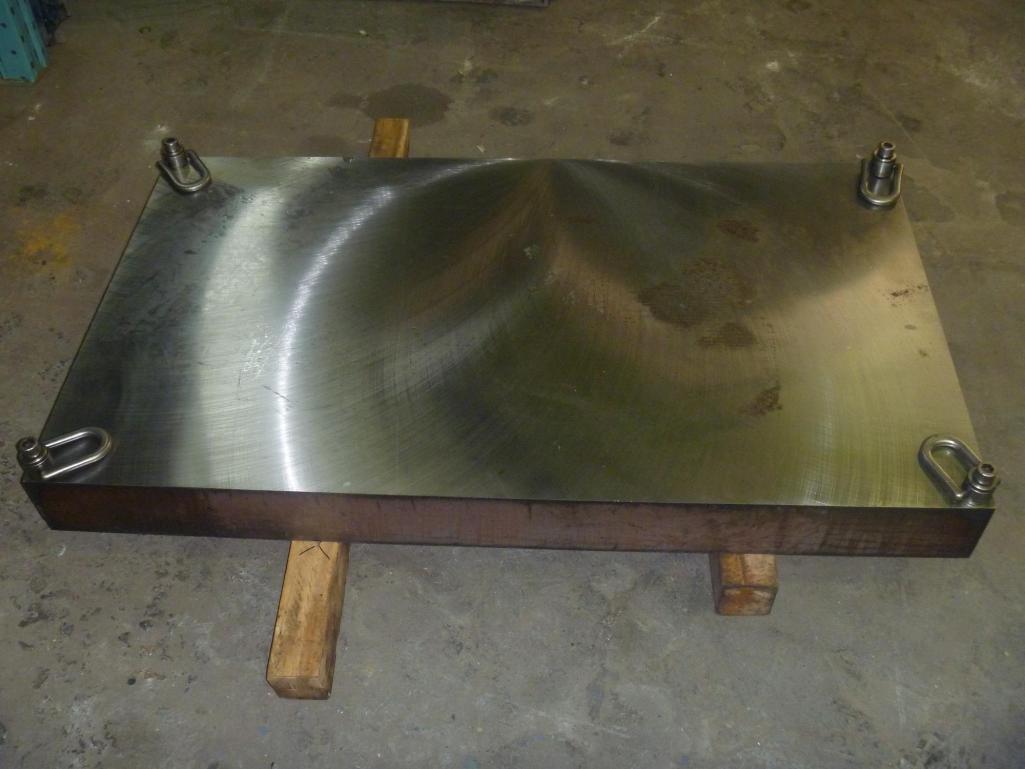

peteyd   OK, came back to work later on. There was a massiv...   Oct 6 2011, 08:24 PM

peteyd   :Qarl: The 1" ballnose finished with no gli...   Oct 7 2011, 08:44 AM
