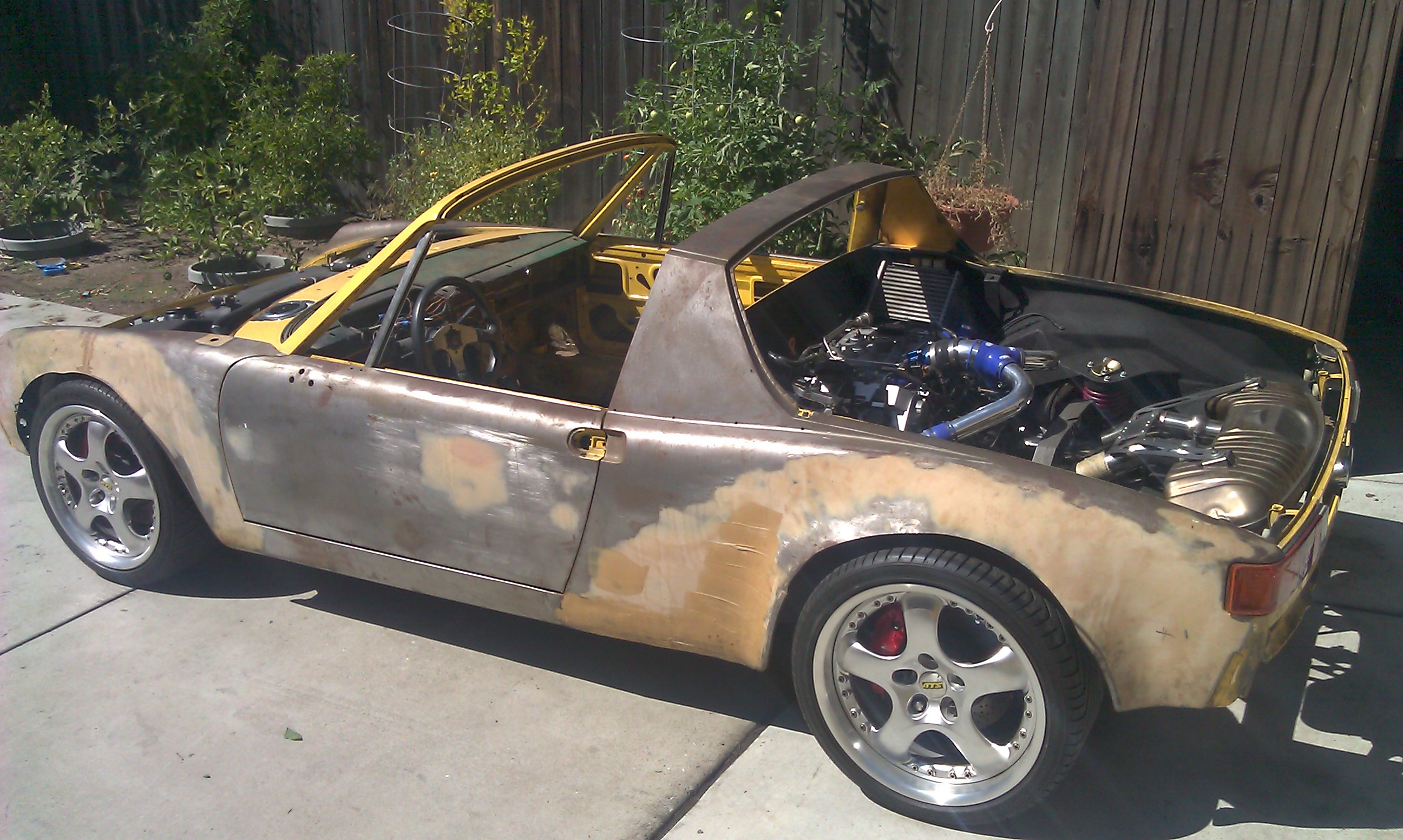

I thought is was time to start a build thread now that it is clear the car will be completed.
The project started as a 1975 1.8 in good condition. Here are the specs for the car.
- Audi 2.7tt v6 with Vems standalone ecu
- Boxster (Audi 012) 5-speed transmission
- F&R suspension from 993
This is how the car has sat for about 10 years

We rolled the car out of the garage to do a good cleaning and took a few shots. Looks like someone besides me is very excited about the car.
