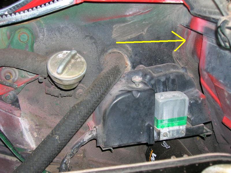

> 914-6 experts whats up with this six?
pete000
post Sep 28 2011, 10:02 PM
Posts: 1,887
Joined: 23-August 10
From: Bradenton Florida
Member No.: 12,094
http://forums.pelicanparts.com/porsche-car...2-914-6-fs.html
This appears to be a 72 and sure looks to have all the correct signs its a real 6. Even has the undercoating on the shock towers. It has a 914-4 vin number.
Eric_Shea
post Sep 30 2011, 09:42 AM
PMB Performance
Posts: 19,304
Joined: 3-September 03
From: Salt Lake City, UT
Member No.: 1,110
I've worked on/seen a grey market 6 tub. There would be a pair of holes in the drivers fender well. They're not there.
I was going to reply with basically what Joe said. The welds on the engine mount and oil line bracket would be telling.
I've seen a lot of conversions and... Someone always misses one little thing somewhere. I just don't see anything missing, from the original looking strut tops (never seen that on a 4) to the dash, DME, hook, oil tank, engine mount etc.
I'd love to lay eyes on the car. The rear trunk numbers are missing... Very hard to say now without seeing the mounts and the areas where the numbers are/were.
Some states will get you a title for anything...
gms
post Sep 30 2011, 10:13 AM
Posts: 2,738
Joined: 12-March 04
From: Chicagoland
Member No.: 1,785
The engine is from a 914/6 built in June 1970 with a VIN of 914.043.2200 +/- 100
The upper fire wall appears to be from a 1970-71 (without retractable seat belts)
post Sep 30 2011, 12:17 PM
Resident German
Posts: 42,469
Joined: 21-January 03
From: Oakland, Kalifornia
Member No.: 179
QUOTE(gms @ Sep 30 2011, 09:13 AM) *
The plot thickens ...
So we know for a fact that the rear firewall is *not* from a '72.
4722917585 is about half way through the '72 model year and at that point they all had retractable seat-belts.
The picture of the firewall clearly shows that this is an earlier tub, which would be in line with the '70 VIN range Glenn posted.
pete000   914-6 experts whats up with this six?   Sep 28 2011, 10:02 PM
Jeffs9146   Its not a real 6! It could be chopped front 4 ...   Sep 28 2011, 10:10 PM
jcambo7   :agree: I don't know much but the whole story ...   Sep 28 2011, 10:12 PM
Eric_Shea   :agree: I'd say check for signs of a front end...   Sep 28 2011, 10:14 PM
pete000   I was wondering about a front end graft as well. L...   Sep 28 2011, 10:16 PM
jcambo7   Link for 914/6 info http://www.914world.com/bbs2/i...   Sep 28 2011, 10:21 PM
JMKnight   :trophy: ALSO the rear valance had a hole which th...   Oct 1 2011, 08:58 AM
Eric_Shea   The more I look at that the more it REALLY puzzles...   Sep 28 2011, 10:32 PM
jcambo7   The more I look at that the more it REALLY puzzle...   Sep 28 2011, 10:35 PM
SirAndy   The more I look at that the more it REALLY puzzles...   Sep 29 2011, 11:53 AM
Eric_Shea   I asked the seller to post the chassis number stam...   Sep 28 2011, 10:32 PM
whitewolf   No numbers I asked the seller to post the chassi...   Oct 3 2011, 10:56 AM
avidfanjpl   I see all kinds of very questionable things in the...   Sep 28 2011, 10:43 PM
pete000   As far as I can see it seems to have whats on that...   Sep 28 2011, 10:44 PM
scrz914   Pretty sure I've seen this one for sale before...   Sep 28 2011, 10:56 PM
bandjoey   Did a 6 have 2 fuel lines ? See the pic with the ...   Sep 28 2011, 11:26 PM
ArtechnikA   Did a 6 have 2 fuel lines ?yes. Recirculating sy...   Sep 29 2011, 03:50 AM
mepstein   The same car sold on Pelican last year for ~...   Sep 29 2011, 04:35 AM
MikeSpraggi   Right tach, wrong speedo on that car. I have a /6...   Sep 29 2011, 06:14 AM
6freak   Right tach, wrong speedo on that car. I have a /...   Sep 29 2011, 07:04 AM
pete000   This car would be a fun one to strip down to metal...   Sep 29 2011, 09:32 AM
rick 918-S   This car would be a fun one to strip down to meta...   Oct 1 2011, 10:29 PM
Cap'n Krusty   When I lived in LA I did 2 swaps from rusty and ot...   Sep 29 2011, 09:59 AM
JmuRiz   Good point. Interesting car for sure...lots of co...   Sep 29 2011, 11:43 AM
boogie_man   It "would" be a fun project for sure. He...   Sep 29 2011, 11:52 AM
mepstein   I almost bought it last year for $6K. Probabl...   Sep 29 2011, 11:57 AM
racerbvd   I almost bought it last year for $6K. Probab...   Sep 29 2011, 02:15 PM
SirAndy   More here: http://forums.pelicanparts.com/porsche...   Sep 29 2011, 12:32 PM
gms   Nothing about this car would make me think it is a...   Sep 29 2011, 02:26 PM
Series9   Nothing about this car would make me think it is ...   Sep 29 2011, 07:51 PM
pete000   If it were that simple, I think it would have be...   Sep 29 2011, 10:52 PM
mepstein   If it were that simple, I think it would have b...   Sep 30 2011, 04:34 AM
Dave_Darling   I think in the old for-sale thread that the owner ...   Sep 30 2011, 02:50 AM
scotty b   THe strut tower "tar" was used on early ...   Sep 30 2011, 04:59 AM
Series9   I think the main thing I'd like to see is the ...   Sep 30 2011, 06:35 AM
racerbvd   :stromberg: :stromberg: Best answer yet :strombe...   Sep 30 2011, 08:20 AM
Eric_Shea   I've worked on/seen a grey market 6 tub. There...   Sep 30 2011, 09:42 AM
gms   The engine is from a 914/6 built in June 1970 with...   Sep 30 2011, 10:13 AM
SirAndy   The engine is from a 914/6 built in June 1970 with...   Sep 30 2011, 12:17 PM
sixerdon   The engine is from a 914/6 built in June 1970 wit...   Oct 1 2011, 07:32 AM
racerbvd   I've worked on/seen a grey market 6 tub. Ther...   Sep 30 2011, 12:12 PM
mepstein   I've seen a lot of conversions and... Someone ...   Sep 30 2011, 10:01 AM
bigkensteele   Would somebody just buy it so we can disect it and...   Sep 30 2011, 01:11 PM
racerbvd   Would somebody just buy it so we can disect it an...   Sep 30 2011, 03:45 PM
rick 918-S   I thought I read once that the 6 wipers park to th...   Sep 30 2011, 01:31 PM
Dave_Darling   I thought I read once that the 6 wipers park to t...   Oct 3 2011, 05:14 PM
A&PGirl   So, is everyone going to put down $$ to ...   Sep 30 2011, 04:27 PM
pete000   The AC hole is probably from the donor 4 front cli...   Oct 1 2011, 09:10 AM
sixerdon   The AC hole is probably from the donor 4 front cl...   Oct 1 2011, 09:37 PM
mgphoto   I was under the impression that any /6 built in ...   Oct 1 2011, 03:01 PM
SirAndy   I was under the impression that any /6 built in ...   Oct 1 2011, 03:34 PM
kg6dxn   Some investigation should be done at the front VIN...   Oct 3 2011, 05:20 PM
Series9   Hey TC, let's offer him $6k. I'll sp...   Oct 4 2011, 05:34 AM
carr914   I'll split it Who gets the Rear Half?   Oct 4 2011, 06:48 AM
Series9   I'll split it Who gets the Rear Half? ...   Oct 4 2011, 05:37 PM
pete000   Only a full chassis strip can reveal the mystery m...   Oct 4 2011, 09:04 AM
