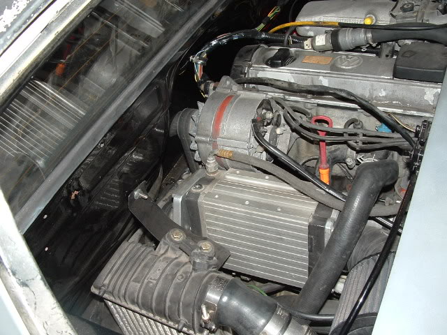

I thought about using the charger off my g60 on my type 4, but went the swap route instead.(IMG:http://www.914world.com/bbs2/uploads_offsite/i106.photobucket.com-1888-1317431639.1.jpg)
