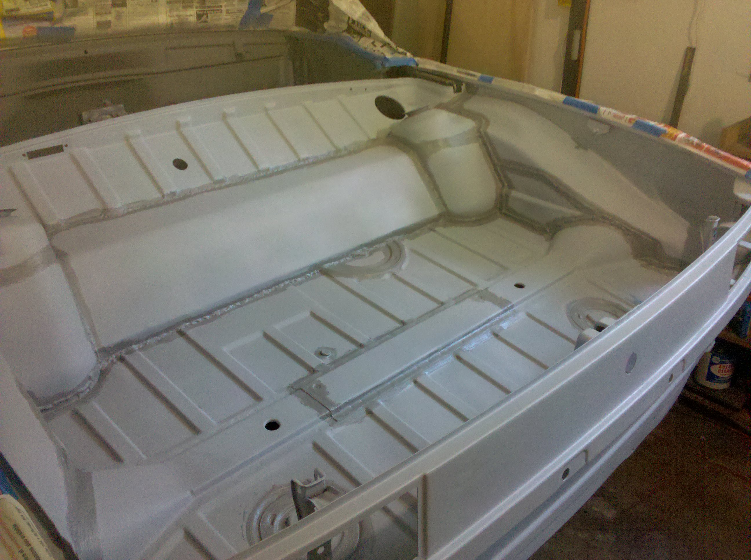

You can cut the trunk and make enough room for the Suby components beneath. Even make it look stockish (IMG:style_emoticons/default/beer.gif)

Brett W   Done right you can use that nice weld-in panel to ...   Oct 5 2011, 11:18 AM
ruby914   Done right you can use that nice weld-in panel to...   Oct 5 2011, 11:35 AM
