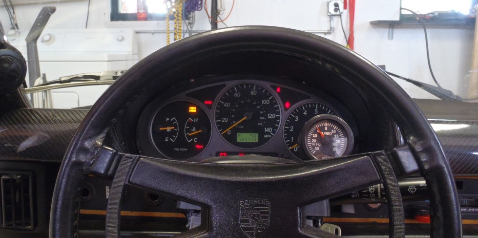

I have a mold that will produce a fiberglass dash for the 914 that the WRX or STI instrument clusters will fit in.
This helps bundle a fully functional plug and play system.
