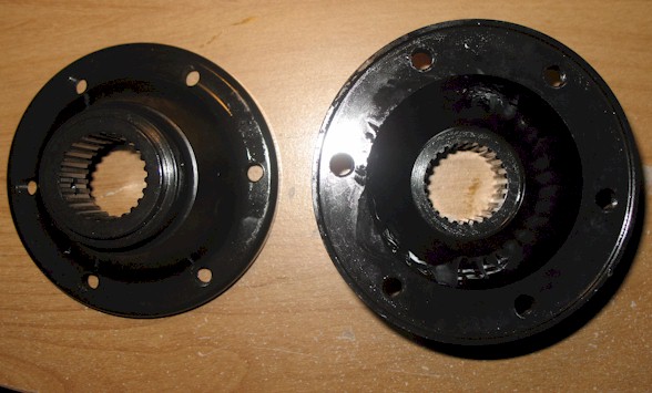

i have a set of porcharu's magic flanges that i never used for sale in case anyone needs a set now - see classifieds. does not work with ALL suby trans - must have same number of splines - i believe early legacy trans is ok and some others but not impreza.
http://www.914world.com/bbs2/index.php?sho...0733&st=680

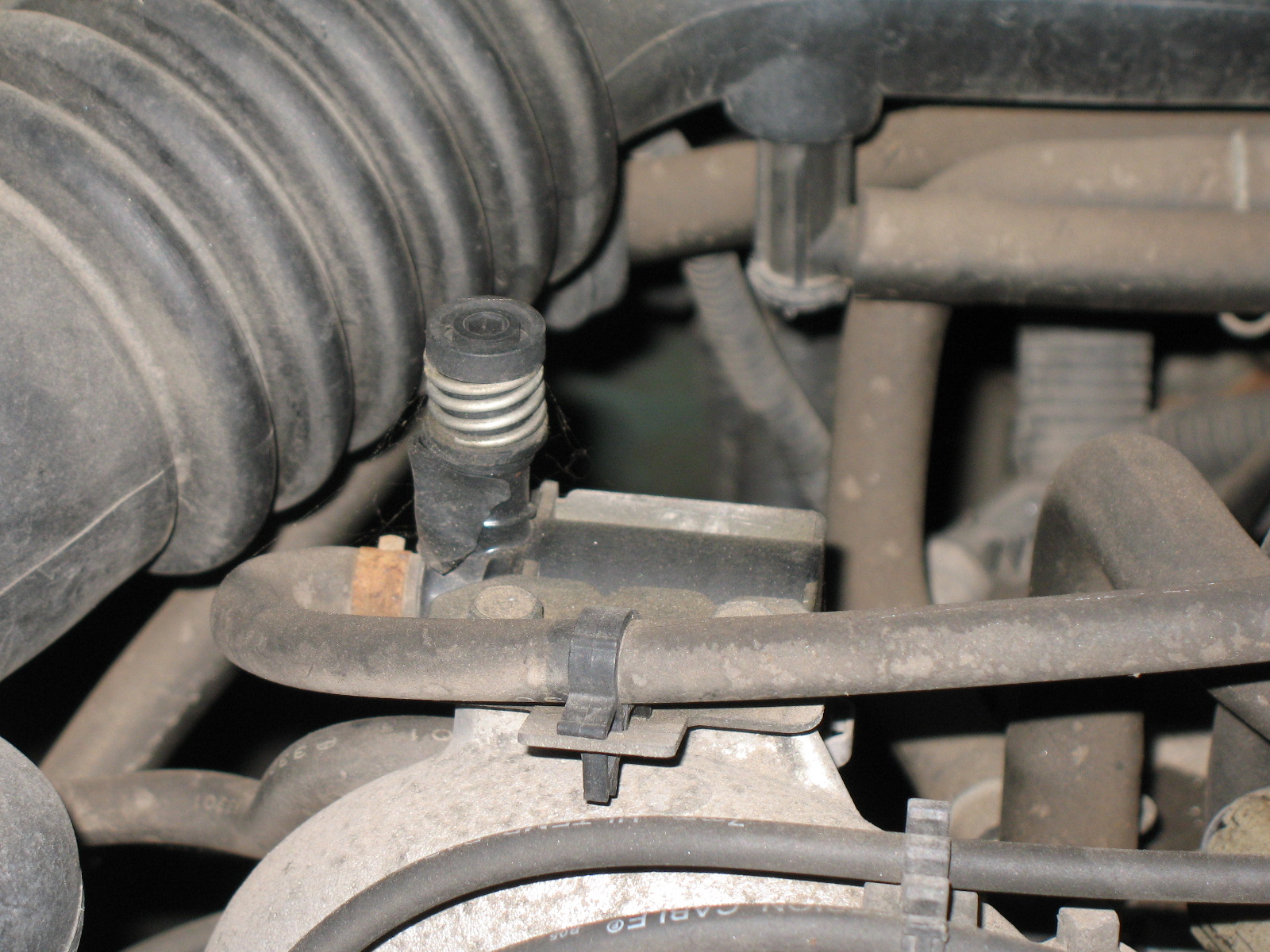

ALSO A QUESTION ?????
would this thing with the spiral coil effect performance - the vaccum line nipple is broken off.

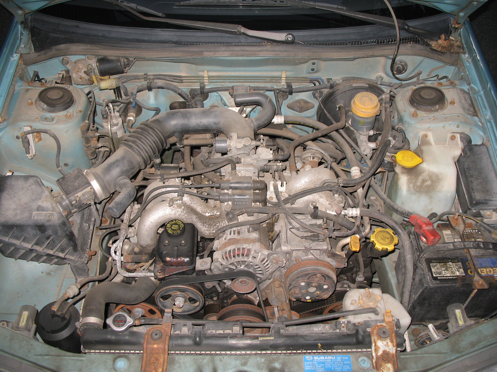

jimkelly   its a 1993 subaru impreza wagon fwd 1.8L IM101 - ...   Oct 6 2011, 08:15 PM
