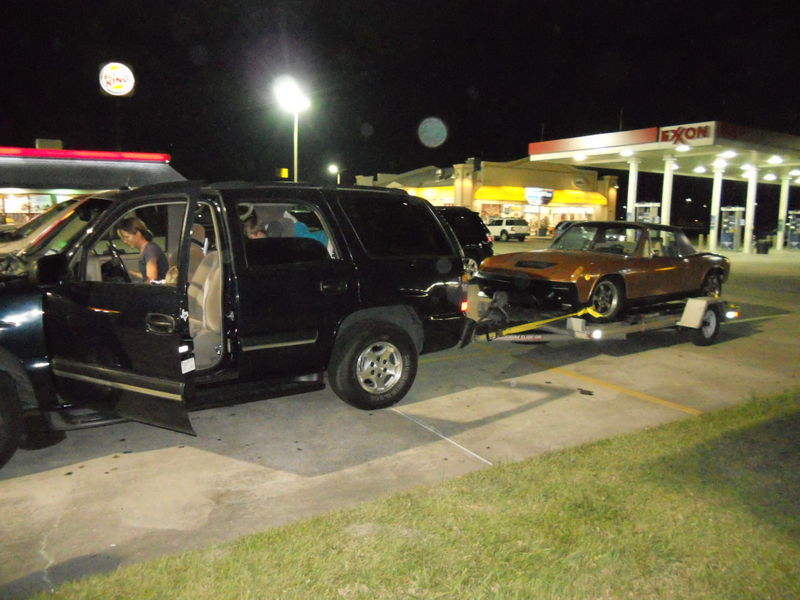

Thankfully, we cleared the state line right at Sunset. I kept driving and eventually needed gas. Gas stop somewhere late in Louisiana.

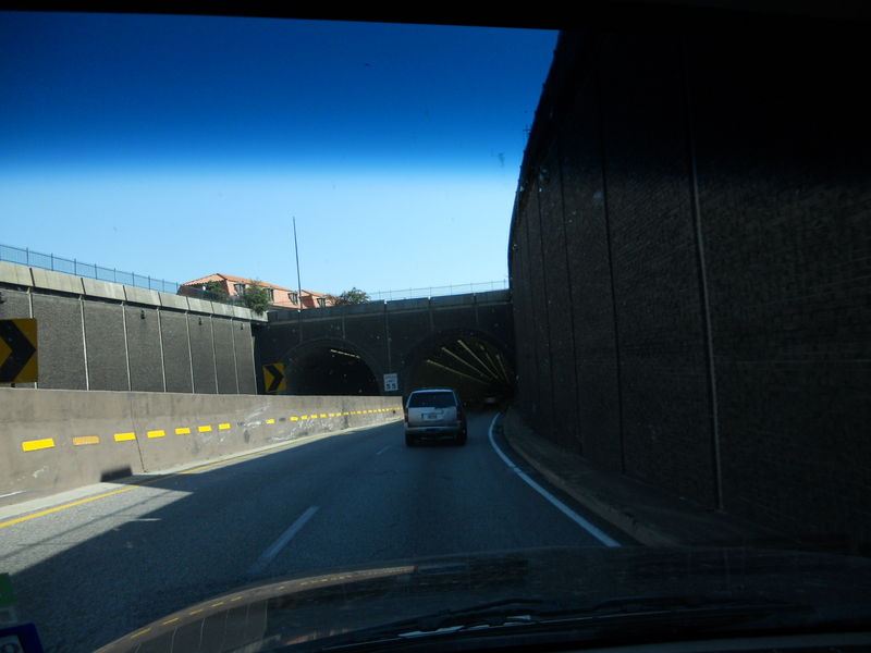

One of the interesting things about the Gulf Coast. There is a tunnel under the main channel of the Port of Mobile. Pretty cool to think that ships are probably going right overhead.

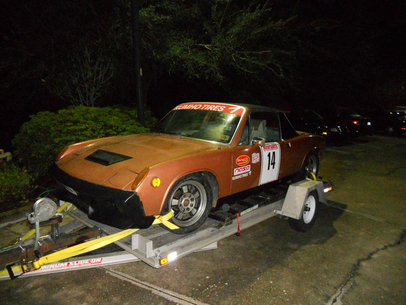

In the parking lot the car generated a lot of interest. There is a lot of creative builds here. I will put up more documentation of the cars tomorrow. I think I already found my favorite. Lots of great people as well.
(IMG:http://www.914world.com/bbs2/uploads_offsite/forums.pelicanparts.com-10736-1317952083.4.jpg)
The car is ready for its track debut. I was given #14 - Fitting for the car.
