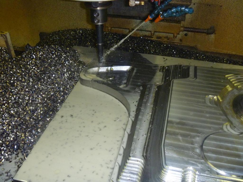

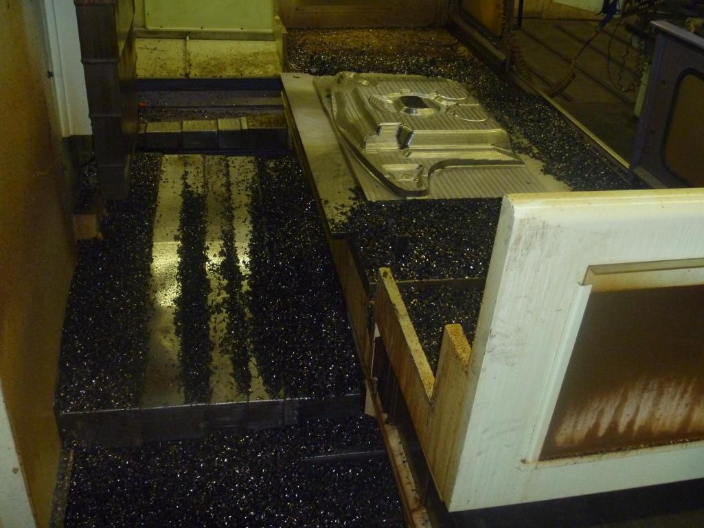

OK, came back to work later on. There was a massive amount of chips this afternoon, so I pause the mill to clear them all. This is the amount of chips that there were when it finished.
And here we are from above...
Now I can start the 1" ballnose. It will be finished by the morning so I can fire up the .5" ballnose. That should run for the rest of the weekend on the finishing pass which has a stepover of .003.

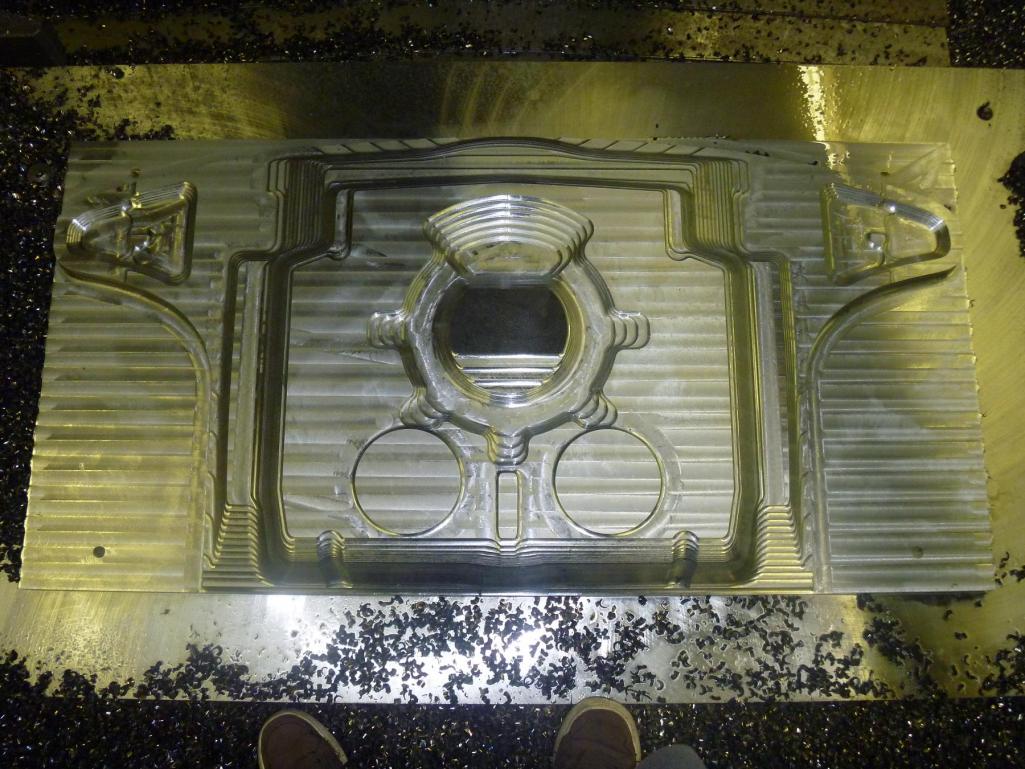

peteyd   OK, came back to work later on. There was a massiv...   Oct 6 2011, 08:24 PM

peteyd   :Qarl: The 1" ballnose finished with no gli...   Oct 7 2011, 08:44 AM
