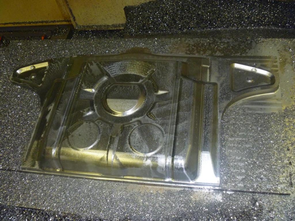

I started with an NOS full floor pan. The one that runs from the firewall all the way to the front trunk pan. Brought that away to get a digital scan and then from there I designed the male and female halves of the die.

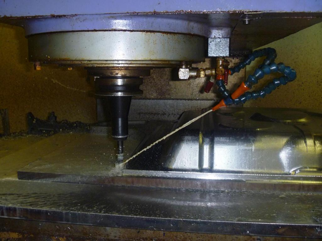

The 1" ballnose finished with no glitches.
The .5" ballnose will run for 180 hrs. Good thing its Canadian Thankgiving this weekend! Taking the rest of the day off and Relaxin at the cottage!
