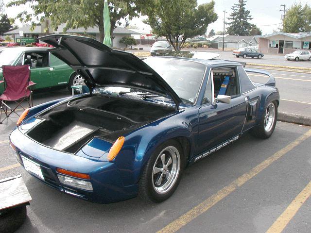

My idea for the radiator in the engine bay is this. I want to use the 2 radiator setup from boxster. My plan is to do it on a flared car. Weather they were GT or Sheridan it should work. Just cut the inlet in the flare on each side for the radiator. Should get plenty of airflow & it would just exit out the wheel well. Should be efficent enough to cool the car. My worry is just cosmetically how to make it flow with the lines of the car. If I could draw for anything I would add an illustration. As it is I think most can figure what I have in mind. I think it would work great. I'm just not sure I can make it look great too (IMG:style_emoticons/default/confused24.gif)
The nicest thing is you keep your front trunk. It also keeps your water lines short & close. It's just a matter of ducting the inlet so it not only looks good but provides enough flow. I have seen a few mods for some forced induction. Anyone have some pics of a 914 with an induction on the side? I've got one of Phillip Haun's car. My thoughs were leaning more towards the Sheridan flare. The GT flare is doable but it would be a tighter squeze as it is flared so close to the wheel/tire. Where the sheridan type is more gradual? Anyway if you have a pic of something along these lines please post them (IMG:style_emoticons/default/pray.gif)
