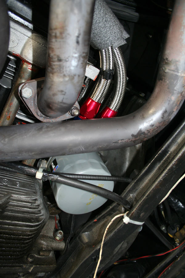

(IMG:style_emoticons/default/agree.gif) I use the sandwich adapter. Easy to install. Works fine. Unless you will be racing a lot and will experience some really hot temps, I think this would work for you.

Euro racing headers. You can find them at http://www.stableenergies.com Click on "performance parts".
