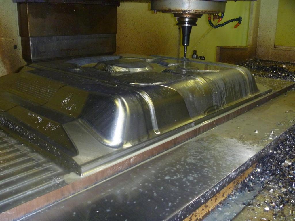

Alright, I spoke a while back that I was going to start producing the Front trunk pan. I already have all the steel and all the CAD work done, so all I need to do is prep the steel and start cutting!
I wanted to start a thread here for all to follow the progress and also to get a better idea of what goes on at Restoration Design. I am the one in charge of designing and making all the dies here for the 914, 911, 912, and 356's. I have only made two small dies( pedal cluster support, seat mount bracket) for the 914 so far so I wanted to make something else that was in need.
I started with an NOS full floor pan. The one that runs from the firewall all the way to the front trunk pan. Brought that away to get a digital scan and then from there I designed the male and female halves of the die.

The power must have gone out this weekend some time between saturday night and sunday morning!
Lost some time! (IMG:style_emoticons/default/headbang.gif)
oh well, (IMG:style_emoticons/default/stromberg.gif) happens. I started it back up on the opposite side, so hopefully it will be done by the beginning of next weekend

peteyd   Did some prep work on the blocks of steal so I can...   Sep 28 2011, 10:28 AM
peteyd   Now I can move them onto the mill and drill and po...   Sep 28 2011, 10:29 AM

peteyd   Loading the steal... I have to clean up an ed...   Sep 30 2011, 10:39 AM
peteyd   Little video... osaKR0WQdfc   Sep 30 2011, 01:15 PM
peteyd   Got some work done yesterday, and set the steel up...   Oct 6 2011, 01:31 PM

peteyd   OK, came back to work later on. There was a massiv...   Oct 6 2011, 08:24 PM

peteyd   :Qarl: The 1" ballnose finished with no gli...   Oct 7 2011, 08:44 AM

peteyd   Well its been a little while since I had an update...   Nov 4 2011, 10:57 AM
zymurgist   Why does the die have to be polished? Just curiou...   Nov 4 2011, 11:26 AM
peteyd   Why does the die have to be polished? Just curio...   Nov 4 2011, 01:14 PM
zymurgist   Why does the die have to be polished? Just curi...   Nov 4 2011, 01:45 PM
peteyd   [quote name='peteyd' post='1566461' date='Nov 4 2...   Nov 4 2011, 05:54 PM
