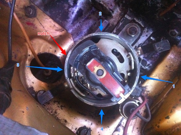

Any thoughts on why I may not be firing on 3&4? This is where the tdc issue came up.
Also, is 132psi too high for #1? #2 has 128, #3 has 120... #4 not sure as can't get there easily at the mo.
I just don't know about my rings on #1. I didn't understand the "top" which is written on these rings... foolishly thought that it meant top of piston as I was looking at it, which made no sense as they would all have the gap in the same direction. I'll pass that uncertainty on to the midnight parking lot jobs I've been stuck with.
Starting with adjustment based on your guide Rich, thanks.
I have some pics here, one is a shot of my distro. Note that the notch is 180 from #1, but all guides say that should align with tdc... just wondering if that is an issue. Want to know if I should worry about it or not.

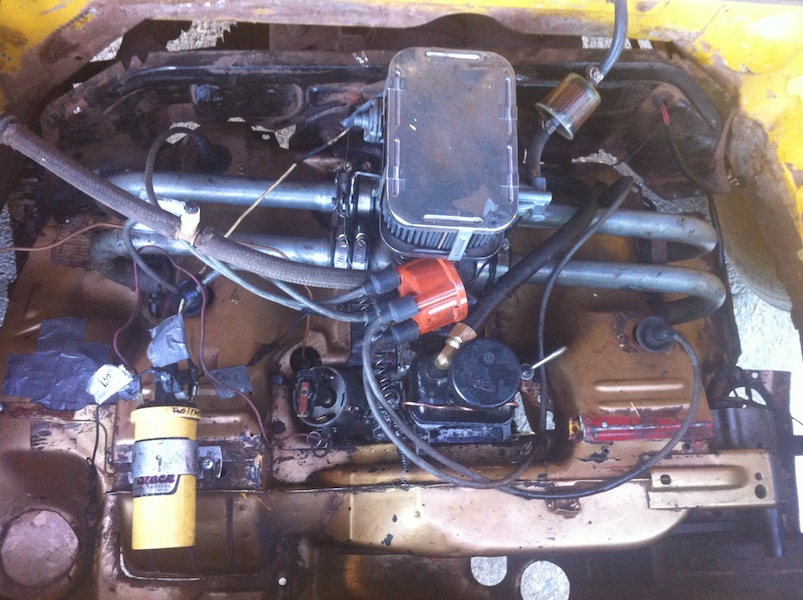

Another is of the engine compartment...

r_towle   It not possible to install the distributor 180 deg...   Oct 10 2011, 09:13 AM
