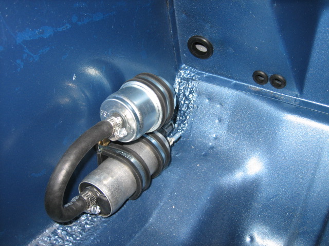

I've got a Carter fuel pump and I'm trying to find a place to locate it. I was thinking there would be room up under the car where the steering rack is but I looked there but can't imagine where I could put it. Not real comfortable with cutting open an access hole where the later cars had them located.
Any good ideas in these photos? ![]() ![]() ![]() Kev |

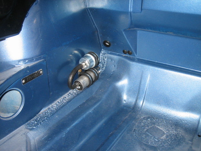

This is where mine ended up. I drilled the two holes for my fuel line and grommeted them and the larger hole for the wire. Used clamps to secure to the inner fender well.
Kev ![]() ![]() |

76-914 Maybe this will help:
The grommets came from a ... Oct 4 2011, 07:14 PM
GeorgeRud Take off the cover that shields the steering rack,... Oct 5 2011, 01:37 PM
kconway
Take off the cover that shields the steering rack... Oct 5 2011, 04:56 PM
Grelber +1 Mine is that same one, and it's underneat... Oct 5 2011, 02:47 PM
Krieger You could put it up about 1' from where it is ... Oct 5 2011, 05:26 PM
gothspeed
You could put it up about 1' from where it is... Oct 10 2011, 12:23 PM
gothspeed Looks good! I like how you used the line betwe... Oct 10 2011, 02:14 PM![]() ![]() |
