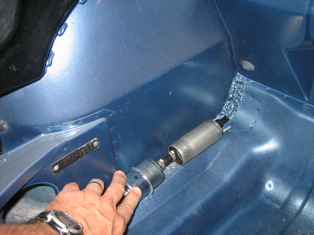

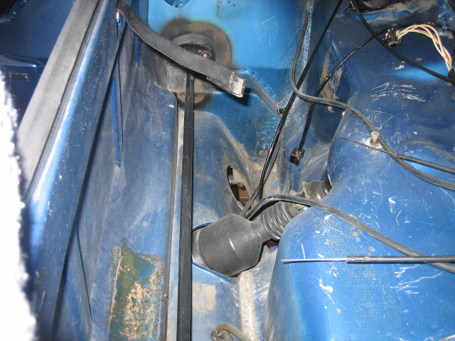

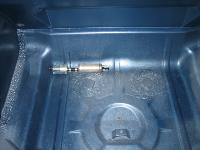

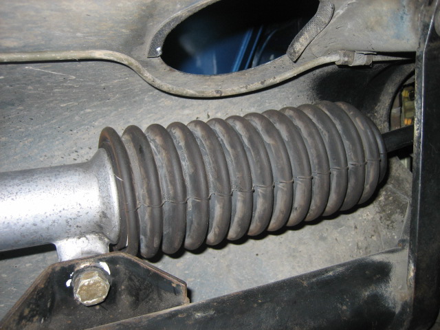

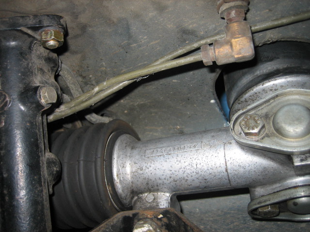

I've got a Carter fuel pump and I'm trying to find a place to locate it. I was thinking there would be room up under the car where the steering rack is but I looked there but can't imagine where I could put it. Not real comfortable with cutting open an access hole where the later cars had them located.
Any good ideas in these photos?

Take off the cover that shields the steering rack, and you should be able to fit the pump next to the rack. This will save you from having to cut holes in the front trunk, and if a leak would develop, it would just drain onto the ground.
Also, the cover will protect the pump but still have it serviceable. Since the fuel lines are already there, why not?
Grelber
+1 Mine is that same one, and it's underneath on the cross member by the steering rack.

I wish I could get a photo of where you put yours. I sure don't see any space under my cover. Did you put it in without the rack in the car or does it cover the access hole to the tank lines or just to the left of that access hole in the first photo?

You could put it up about 1' from where it is located in your first pic. In that indentation. Some 911s had them on the front aluminum suspension crossmember. Some people go as far as getting a later access panel cover (75-76) and cutting a hole in that indentation so the pump sits just above/infront of where brake resevoir hoses go through body to the master cylinder.

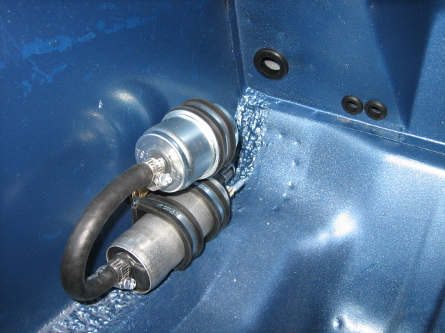

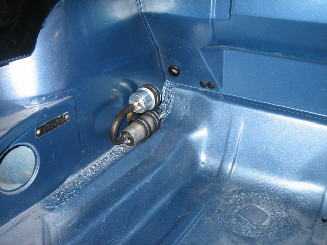

This is where mine ended up. I drilled the two holes for my fuel line and grommeted them and the larger hole for the wire. Used clamps to secure to the inner fender well.

Looks good! I like how you used the line between the filter and the pump to make that 180° turn. So both to/from lines will be a straight shot.
