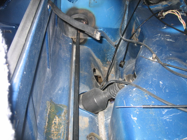

I've got a Carter fuel pump and I'm trying to find a place to locate it. I was thinking there would be room up under the car where the steering rack is but I looked there but can't imagine where I could put it. Not real comfortable with cutting open an access hole where the later cars had them located.
Any good ideas in these photos?

Take off the cover that shields the steering rack, and you should be able to fit the pump next to the rack. This will save you from having to cut holes in the front trunk, and if a leak would develop, it would just drain onto the ground.
Also, the cover will protect the pump but still have it serviceable. Since the fuel lines are already there, why not?

+1 Mine is that same one, and it's underneath on the cross member by the steering rack.

QUOTE(GeorgeRud @ Oct 5 2011, 12:37 PM) *
I wish I could get a photo of where you put yours. I sure don't see any space under my cover. Did you put it in without the rack in the car or does it cover the access hole to the tank lines or just to the left of that access hole in the first photo?

You could put it up about 1' from where it is located in your first pic. In that indentation. Some 911s had them on the front aluminum suspension crossmember. Some people go as far as getting a later access panel cover (75-76) and cutting a hole in that indentation so the pump sits just above/infront of where brake resevoir hoses go through body to the master cylinder.

QUOTE(Krieger @ Oct 5 2011, 04:26 PM) *
^^ +1 ...... I was thinking the same thing. I am going through this fuel pump location issue myself. There is already a hole where the windsheild washer airline went through that is big enough for both to and from lines (just needs a grommet). It makes a lot of sense to put it in that location, as if it ever goes bad and one is short on tools, one can install a replacement with only a screwdriver for the hose clamps. Downside; associated fuel smell if/when any fuel spills.
The other location I am contemplating is on the lower steering cover panel itself. I was thinking of using longer lines and attach it with some rubber mounts. So it comes down when I remove the panel. Downside; would be a bit more work to replace it, should or when it goes bad.

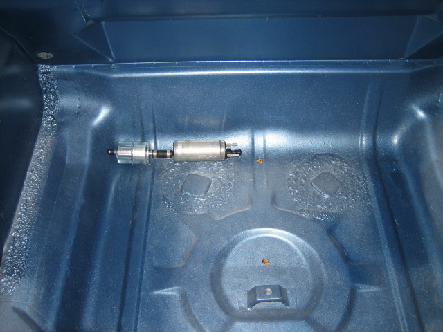

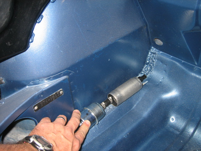

kconway
post Oct 10 2011, 01:23 PM
Posts: 1,347
Joined: 6-December 04
From: Monrovia, CA
Member No.: 3,231
This is where mine ended up. I drilled the two holes for my fuel line and grommeted them and the larger hole for the wire. Used clamps to secure to the inner fender well.

gothspeed
post Oct 10 2011, 02:14 PM
Posts: 1,539
Joined: 3-February 09
From: SoCal
Member No.: 10,019
Looks good! I like how you used the line between the filter and the pump to make that 180° turn. So both to/from lines will be a straight shot.
Thanks for the follow up pics, it looks good! (IMG:style_emoticons/default/beerchug.gif)
