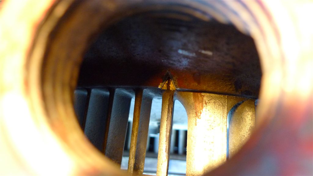

I'm viewing the great valve adjustment article over at pelican & have my one wheel off the ground to get it just right but I have no viewing ports into my flywheel.
How then can I get the tdc worked out? I did the straw in the #1 cylinder trick too, put it in & note when it is most pushed out and before it goes back into the chamber... But it still feels like its not just right. Thought? |

r_towle you are at TDC when the Intake valve is just about... Oct 10 2011, 09:22 AM
Radmacdaddy Looks like I've been real close to tdc all alo... Oct 10 2011, 09:29 AM
