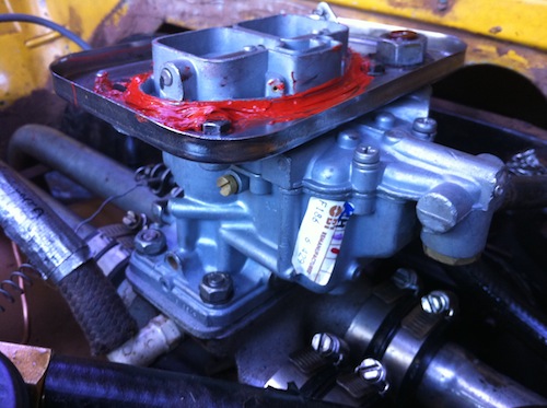

New Carb pics...
just installed, going for a test drive:

vsg914   Why the rtv?   Oct 12 2011, 11:49 AM
r_towle   Randy, Go this way home.... Check it out... http:...   Oct 12 2011, 01:35 PM
wingnut86   He's out of Duct Tape... <grin>   Oct 12 2011, 01:36 PM
Radmacdaddy   What's rtv? I did one hell of a repair on the...   Oct 12 2011, 05:49 PM
Dave_Darling   What's rtv? Room Temperature Vulcanizing sil...   Oct 12 2011, 07:02 PM
