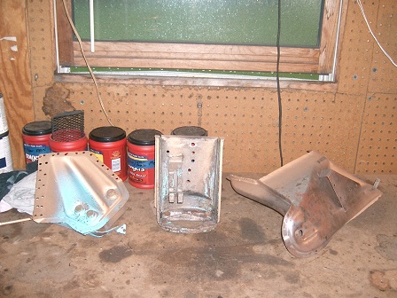

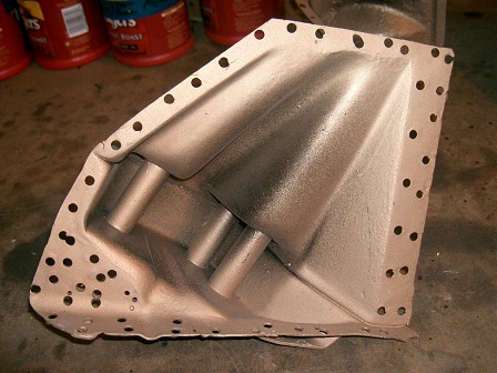

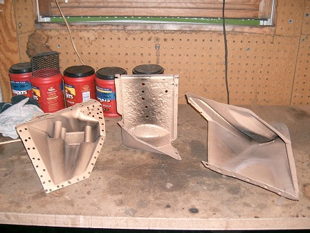

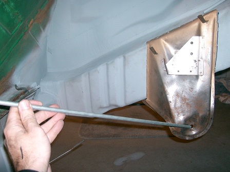

The outer suspension console and engine mount were completely shot on my car, so I bought a relatively rust free chunk of longitudinal from a member of 914world and started disassembly. What a PITA drilling out all of the spot welds and grinding down the outer welds, then beating the pieces apart with a large hammer and screwdriver. My "original" inner suspension console must have been replaced at some point, because it was in better condition than the one I bought as part of the used longitudinal. All three pieces were treated with POR-15 on the inside while the weldable areas were shot with weld thru primer. I continually ran a piece of safety wire through the drain hole of the inner console while treating with POR to make sure the drain remained open.
Parts:

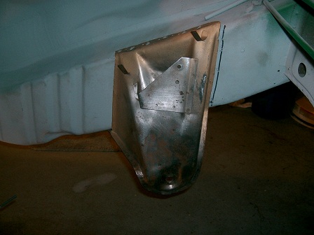

I decided to start with the inner console. It was a real bitch trying to measure exactly 28 1/4 inches from the hole in the center of the firewall to the front of the suspension ear hole with a tape measure while holding everything in place. Plus, this needs to be spot on for proper alignment. I decided to cut a piece of steel brake line to exactly 28.25" to simplify the task.

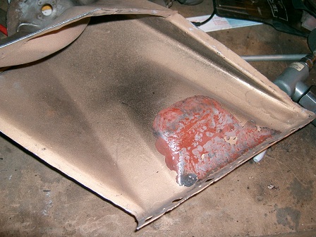

The inner console had a little bit of "rock" to it on the new long that seemed to be coming from the indent behind the bracket. Had to beat this area with a hammer for proper fit:
Still nervous about having the measurements EXACTLY right before tack welding this thing in place...I decided to call it a night.
