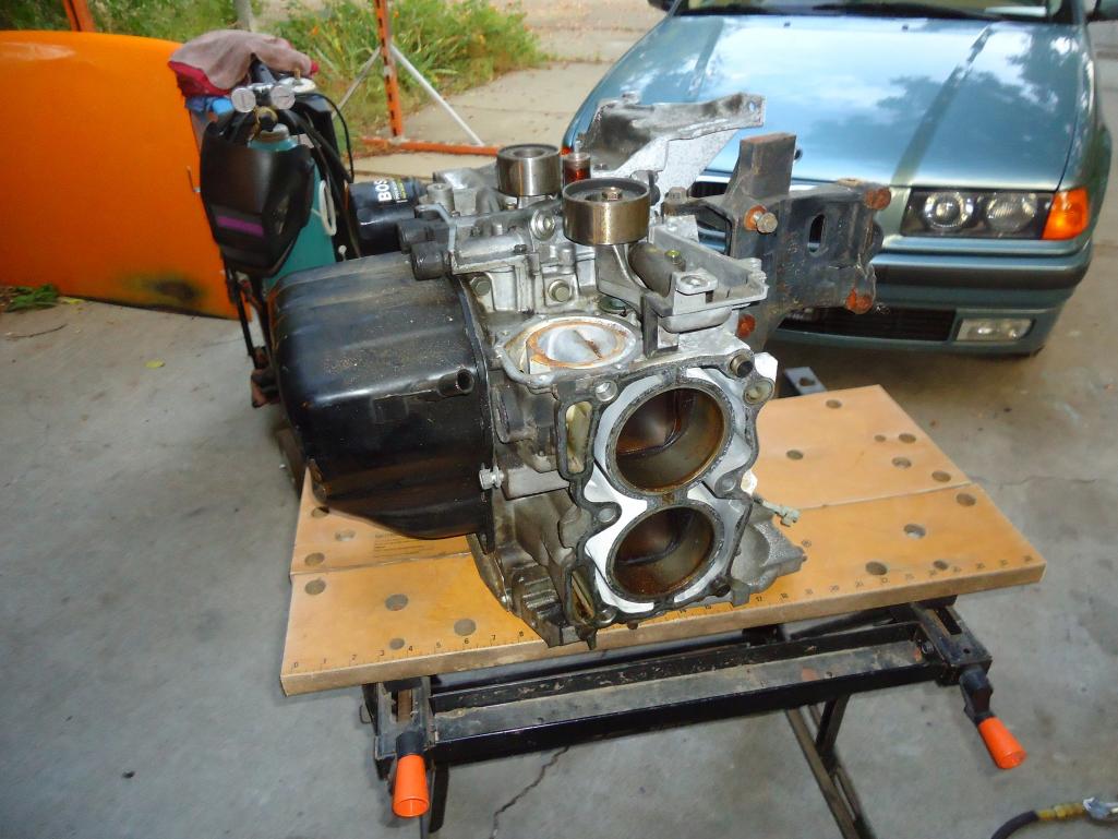

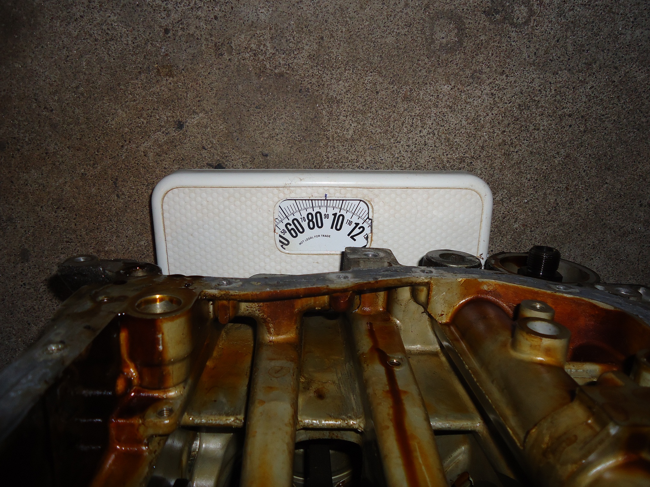

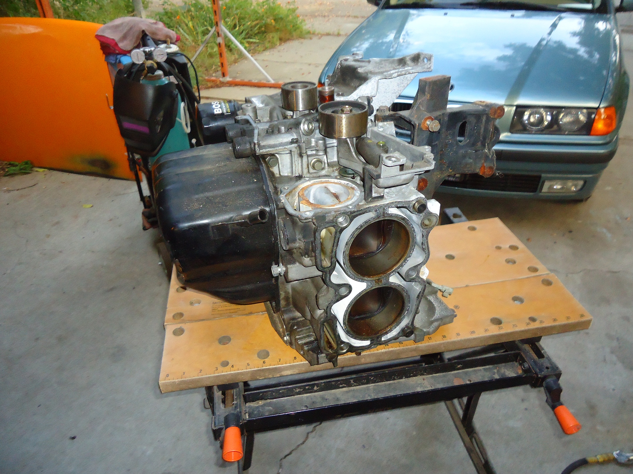

Jamie, I finally got time to strip the Subaru EJ20 turbo shortblock and weigh it. I removed the oil pan & pick-up, oil pump, AC & alternator mounts, pulleys, sensors, tensioner & mount, and oil windage tray. As you can see, it weighs 95 pounds according to my old bathroom scale. If we add ~4 pounds for packing materials, it looks like it will cost ~$102 via Greyhound Sacramento to Austin. However, their maximum weight is 100 pounds, so there might be good reason for you to check other shipping methods.
I have never run this engine, so I don't know if there are any problems in the bottom end. But I cannot feel any movement in the rod bearings. The oil pan is clean without any metals debris, too, so there are no obvious problems. The cylinder walls look good, with no gouges at all.
Like I said, it is yours for the cost of shipping. Let me know if you're still interested.
