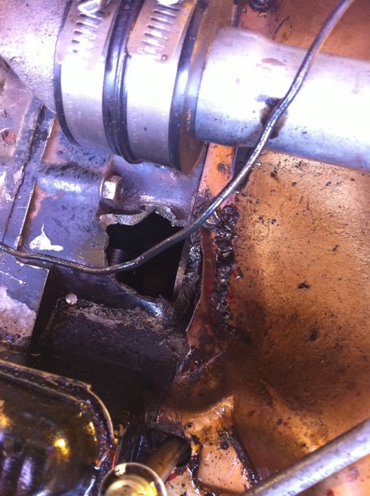

crank case damage:
(IMG:http://www.914world.com/bbs2/uploads_offsite/a2.sphotos.ak.fbcdn.net-13617-1318897812.1.jpg)

Radmacdaddy   As rich mentioned, the case is blown, I have about...   Oct 17 2011, 03:05 PM
Radmacdaddy   crank case damage: http://www.914world.com/bbs2/up...   Oct 17 2011, 06:30 PM
wingnut86   Don't toss the case Randy. They aren't bu...   Oct 17 2011, 07:10 PM
