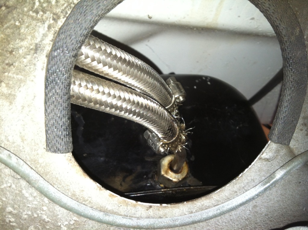

The prior owner of my car tried to coat the fuel tank in my 1974 914 but it ended up flaking off. I didn't feel like messing with trying to remove the coating so I ended up looking for another tank.
Thanks to fellow member Bruce Stone (bdstone914) I now have a usable fuel tank which I need to install. The problem I am now facing is how to get the old fuel lines off and remove the tank. The problem is how to get to those hose clamps given the lack of space.
(IMG:http://www.914world.com/bbs2/uploads_offsite/i954.photobucket.com-11663-1318800639.1.jpg)
I'm also concerned about getting them re-attached properly when the new tank goes in. So are there any tricks to doing this? I tried to lift the tank partway up to get to the lines but it felt like the lines were holding it in place.
Any suggestions would be greatly appreciated.
Thanks.

Tom   Rob, Might be able to get a small 1/4" soc...   Oct 16 2011, 03:38 PM
sfrenck   Could you lift the tank up a bit first so you have...   Oct 16 2011, 03:40 PM
rjames   If you aren't going to reuse the lines, just c...   Oct 16 2011, 03:48 PM
moparrob   If you aren't going to reuse the lines, just ...   Oct 16 2011, 04:34 PM
swl   he had to get it in there somehow. Most likely th...   Oct 16 2011, 04:24 PM
scotty b   How much line is in the car body ? From the factor...   Oct 16 2011, 04:33 PM
sfrenck   How much line is in the car body ? From the facto...   Oct 16 2011, 04:39 PM
9146986   If you have a set of small ignition wrenches you m...   Oct 16 2011, 04:40 PM
moparrob   Thanks Scotty - I'll check it out.   Oct 16 2011, 05:10 PM
moparrob   *SOLVED* In the end brute force prevailed. Altho...   Oct 16 2011, 11:33 PM
