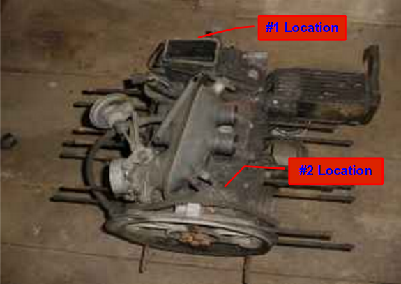

Randy,
See if the seller can check 2 points on the block for you, small bit of cleaning with a paper towel wet with Dawn or similar dish soap and water would help - damp, not dripping wet.
#1 - main location for model# of block, located in front of the case breather/port on the flat surface that resides between the fan housing and the case
#2 - secondary location on some blocks. Diagonal flat metal area just behind the transmission mounting flange
*if neither location has a number located/stamped on them then it is probably a factory replacement case used to replace a bad case. The factory released these specifically as replacements and the dealer or service owner was supposed to stamp the block with a designated number prior to the install/replacement (many didn't do this).
This is the "EASY" way of determining what he has (IMG:style_emoticons/default/beer3.gif)
