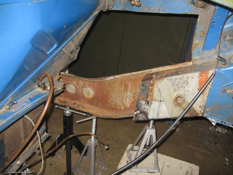

nathansnathan   Moving slowly along, some more work on the door br...   Dec 14 2010, 08:32 PM
kg6dxn   Nice welding! :first: I wish my skills were ...   Dec 14 2010, 09:56 PM

nathansnathan   The long is made up of like 15 different pieces. ...   Dec 11 2011, 12:25 AM
nathansnathan   :ttiwwp: :poke: I haven't documented the b...   Dec 11 2011, 12:30 AM
Elliot Cannon   Great work on the car. Good on ya for saving one....   Dec 11 2011, 12:38 AM
nathansnathan   Great work on the car. Good on ya for saving one...   Dec 11 2011, 12:46 AM
kg6dxn   Great work on the car. Good on ya for saving on...   Dec 11 2011, 12:52 AM
FourBlades   You are a real craftsman, this is some of the most...   Dec 11 2011, 06:27 AM
saigon71   Your craftsmanship is awesome! :beer2: Our c...   Dec 11 2011, 07:32 AM
sixnotfour   Spider bite , nasty, get well. Awesome splice wo...   Dec 11 2011, 08:23 AM
BarberDave   :trophy: WOW, What talent !!! ...   Dec 11 2011, 09:00 AM
nathansnathan   Thanks, guys for all the compliments/ encouragemen...   Dec 11 2011, 02:14 PM

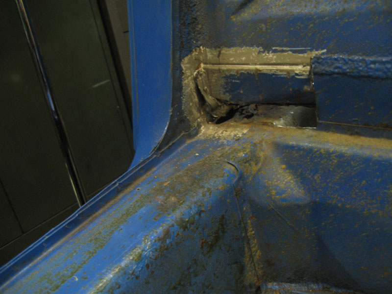

SirAndy   The way restoration design does the hell hole repa...   Dec 11 2011, 02:27 PM
