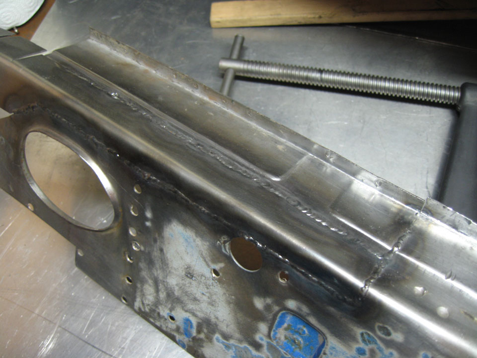

To show it before and during adds drama and makes it look like I am progressing faster. (IMG:style_emoticons/default/piratenanner.gif)

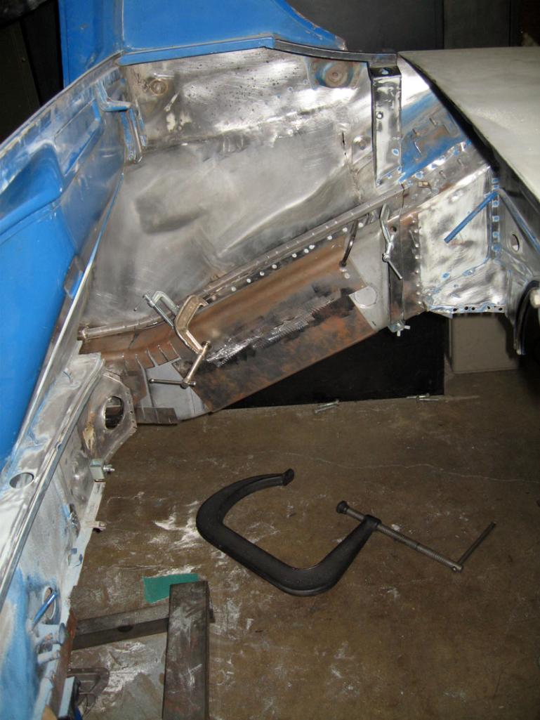

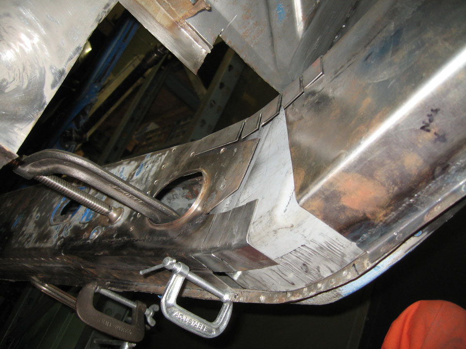

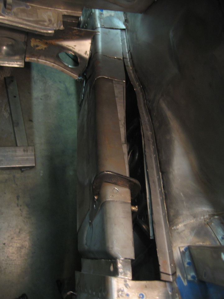

A bit of fitting up, a few pieces put together, some tricky bit to do at the bottom.
Welding is coming along, could be prettier. I will grind the butt welds though.
Almost have all the pieces.. I do have that back bit with the recessed hole for behind the inner console.
A bit of rust color there, a lot of handling going on, but well get it clean before it goes back together.

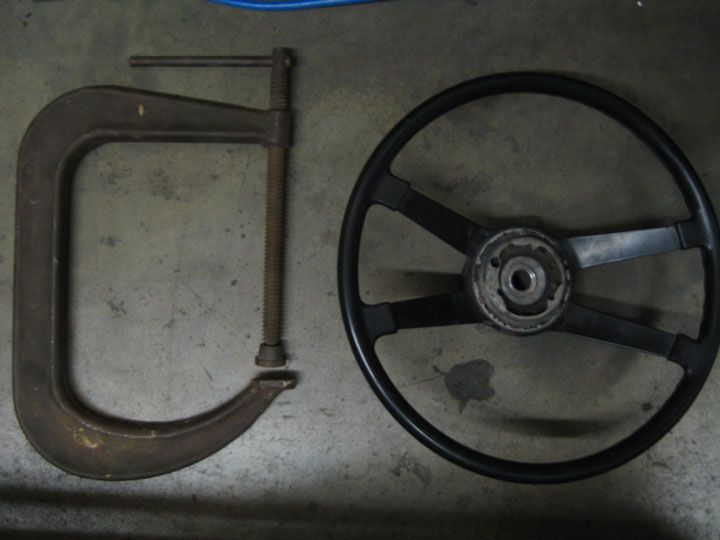

I got my big-ass clamp. Who knew 8 inches could be so big. I blasted, sanded and painted it with high temp paint.
I've got the stuff to put down epoxy primer though. A few things to do before I can spray any. (IMG:style_emoticons/default/bye1.gif)
