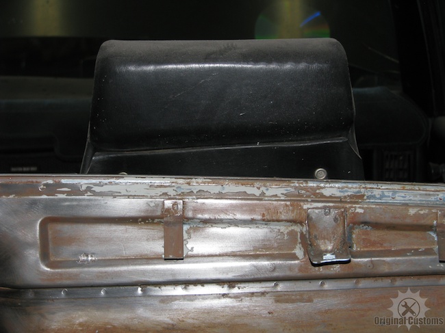

I just woner if the driver's seat is identical to the passenger's seat
of course I'm talking abut the later seats and - would a late passenger seat fit at the early driver's seat (IMG:style_emoticons/default/confused24.gif) (IMG:style_emoticons/default/beerchug.gif) Gustl |

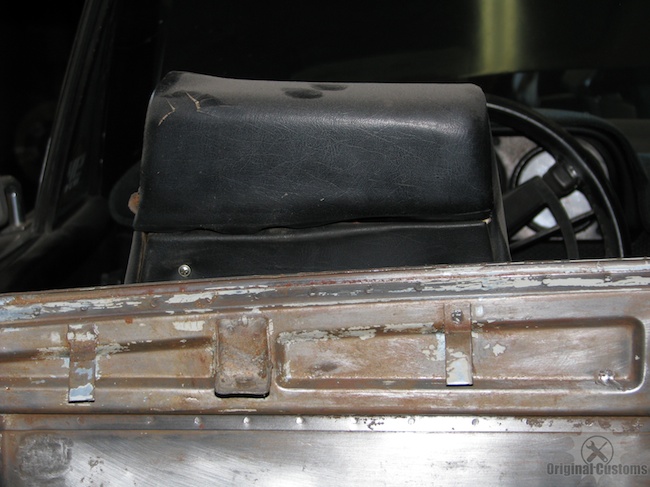

I stand corrected... The rear 'seam' has an angle to it. Here you can see my 914 happens to have two driver's side seats in it.

McMark They're all the same, except for the railings ... Oct 23 2011, 11:44 AM
kg6dxn What about the angle of the back of the headrest? ... Oct 23 2011, 11:47 AM
poorsche914 The driver seat has an "indent" area alo... Oct 23 2011, 12:08 PM
sfrenck I switched mine - but there is a difference in the... Oct 23 2011, 12:58 PM
Gustl
I switched mine - but there is a difference in th... Oct 23 2011, 03:04 PM
sfrenck
I switched mine - but there is a difference in t... Oct 23 2011, 04:11 PM
TargaToy On my 72, there's a difference in the side bol... Oct 23 2011, 08:26 PM
Gustl thanks all for help :worship: Oct 23 2011, 10:12 PM
skaufmann Drivers side has narrower side-pad to give extra c... Oct 26 2011, 12:11 AM![]() ![]() |
