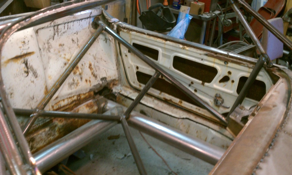

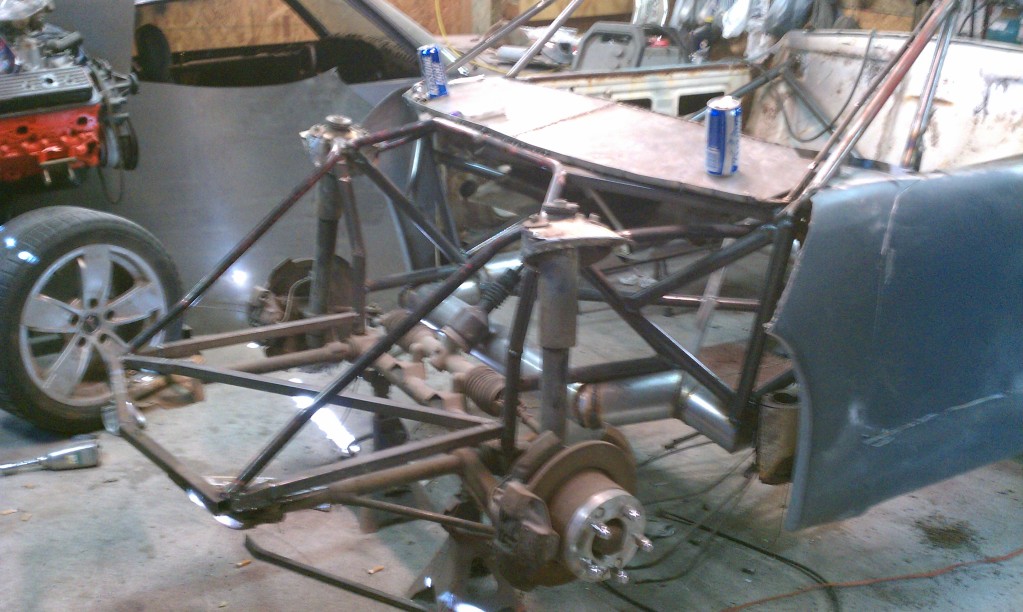

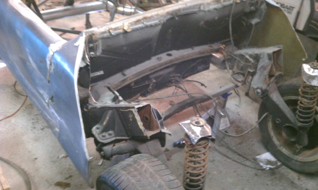

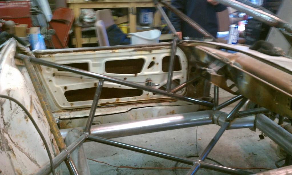

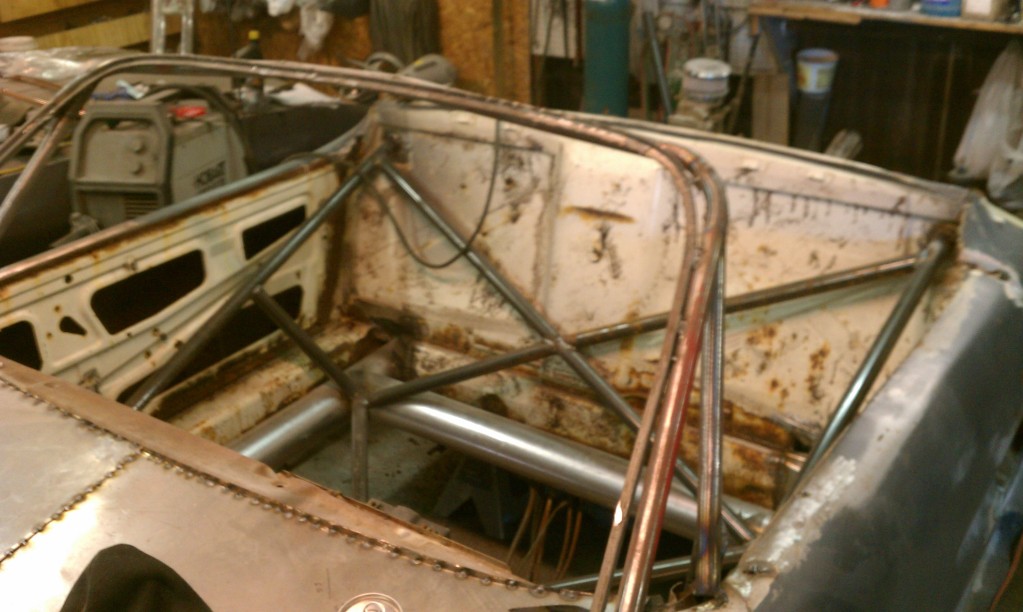

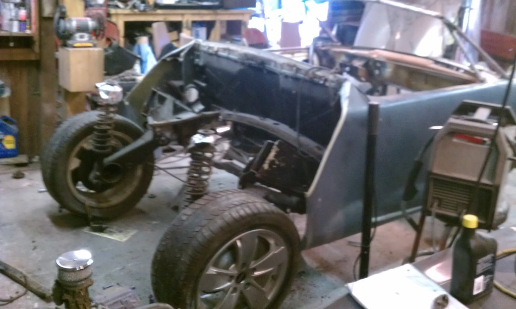

I did a lot more cutting and laid more tubes this weekend and last week.
Started getting the rear cut apart to make room for the new rear half of the chassis.
After I get the rear suspension tied back in I'm going to cut the stock rockers out, since they won't be needed any more and remove most of the rear firewall to make my drivetrain swap easier. By getting rid of the rockers I will have plenty of room to run coolant tubes if needed
