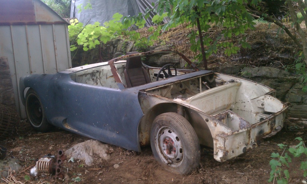

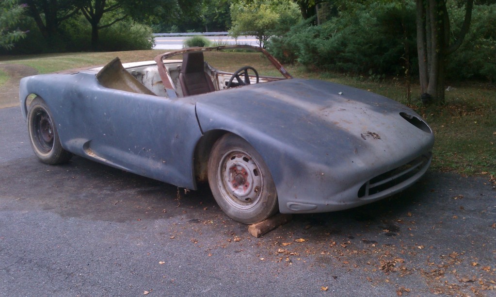

About 12 years ago I was looking for a fun kit car project and ended up being GIVEN a 73 Porsche 914 project someone had started and abandoned.....guess either they ran out of money, time or got in over their head, but either way it ended up with me getting a free car smile.gif
I ended up storing it at my parents house under a tarp behind the shed and then it sat in the same spot til a few weeks ago when I put it on a trailer and brought it to my house.
This is what it looked like when I loaded it up on the trailer
IPB Image
IPB Image
IPB Image

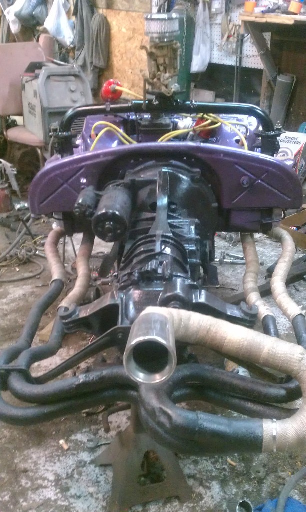

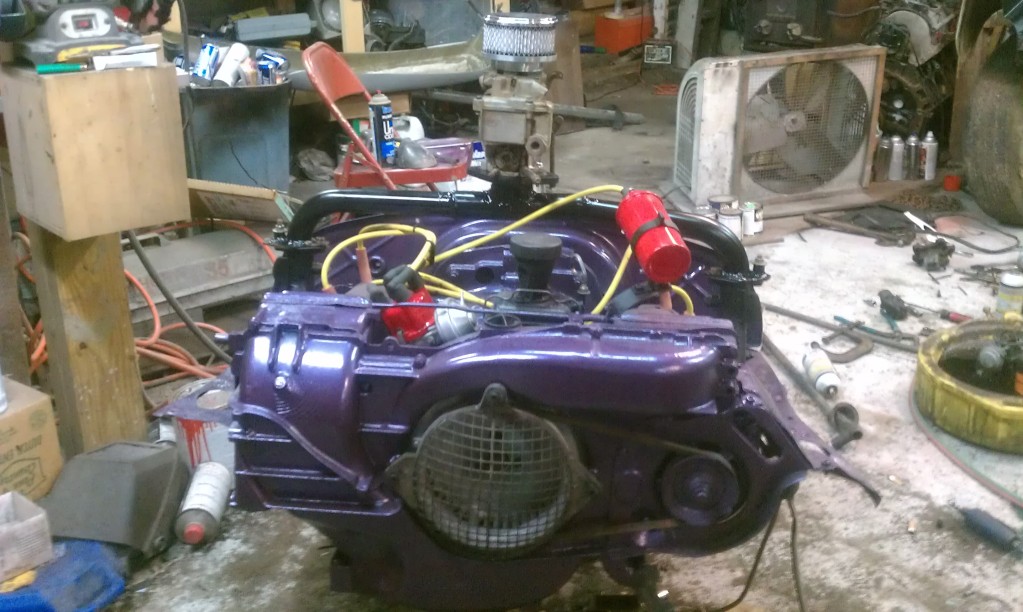

I first started by dropping out the engine/ tranny, tore the motor down, cleaned, honed and reassembled then painted
IPB Image
IPB Image

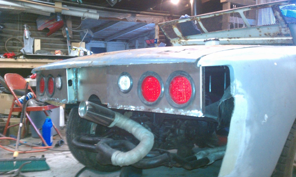

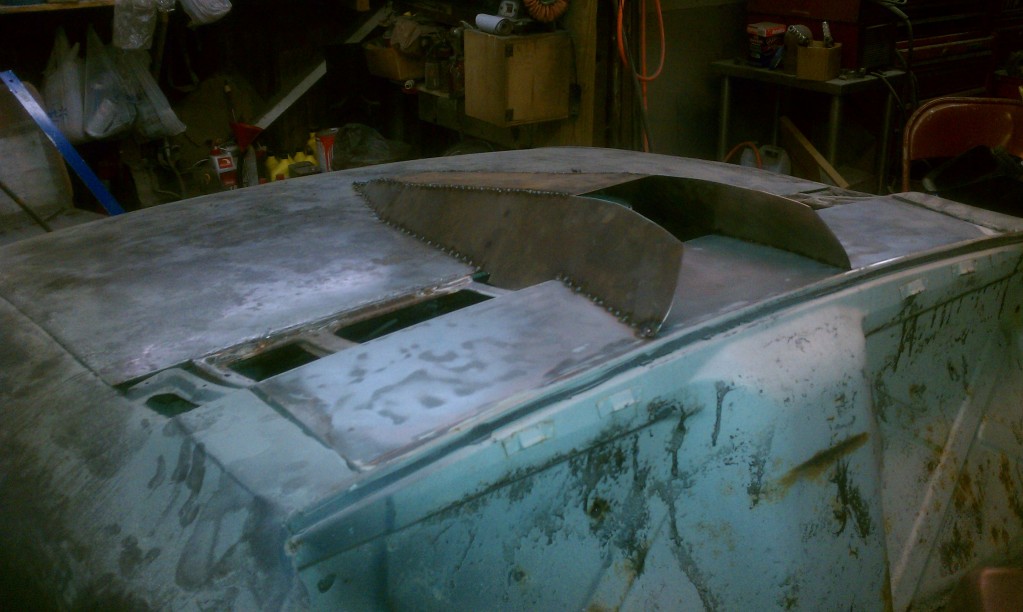

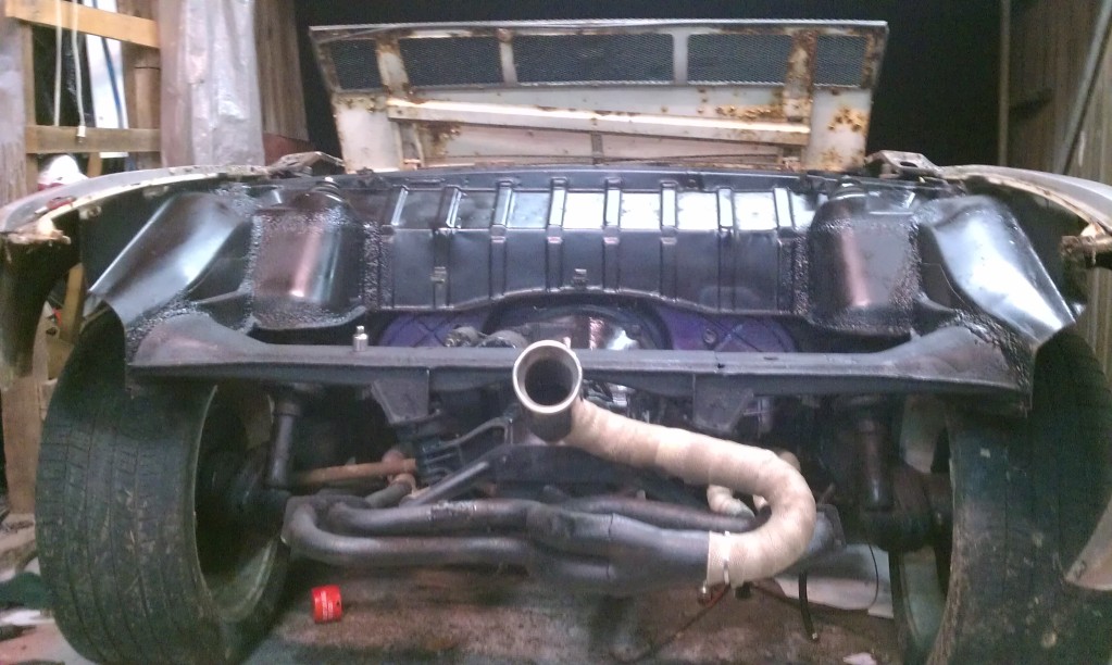

After the drivetrain was finished I bolted it back in and moved on to the rear decklid and engine cover and fabricated the tail light section, welded the trunk and decklid together to make them one peice. To add strength to the two prices so they didn't tear themselves apart......and get a completely new look I made an intake scoop and air foils.
IPB Image
http://i283.photobucket.com/albums/kk300/m.../IMAG0280-1.jpg
IPB Image
IPB Image
IPB Image

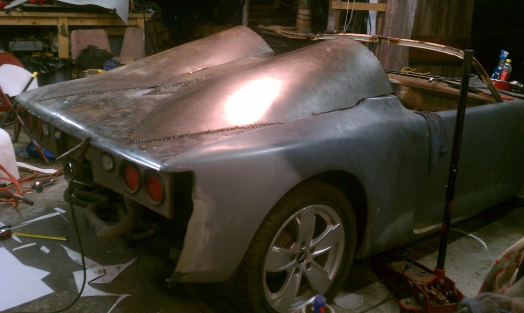

mark21742

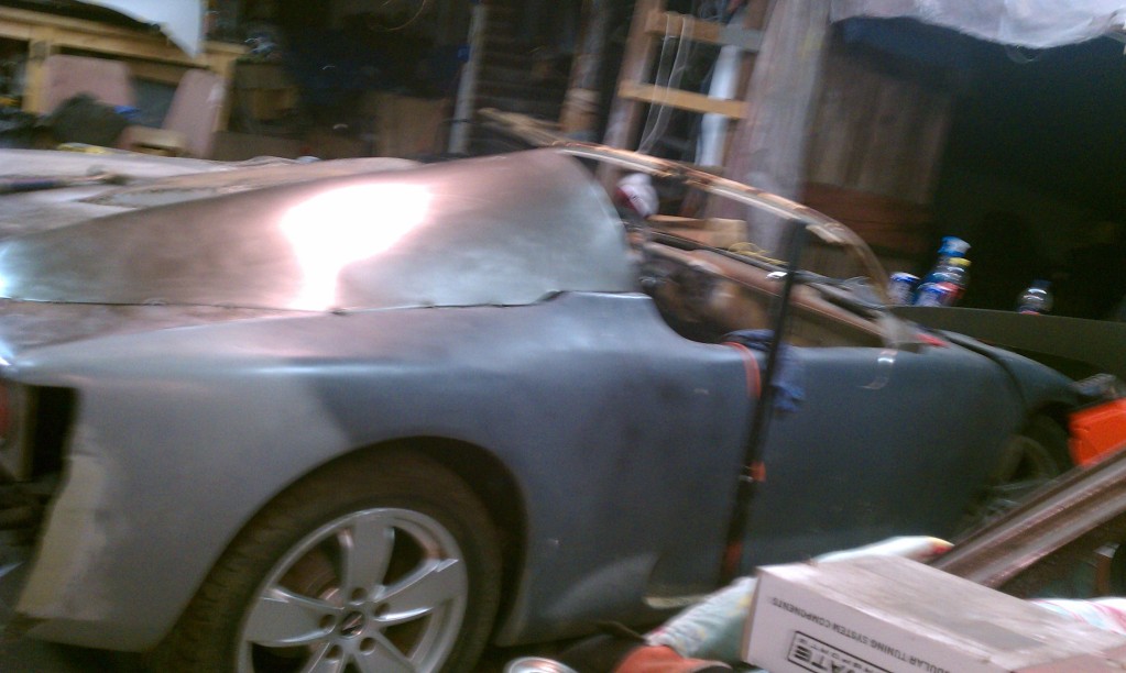

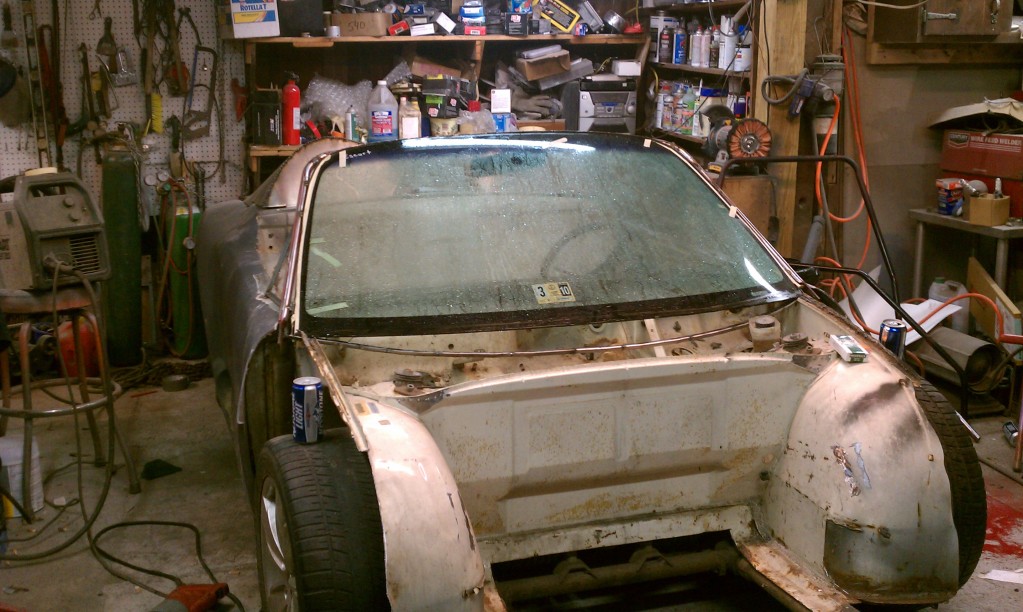

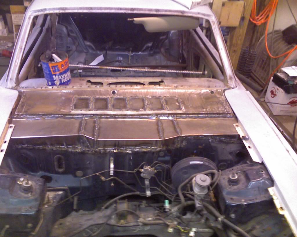

Next step was a new windsheild line and look.....I did some searching and lots of measuring to come up with a 98 Ford escort windshield
IPB Image

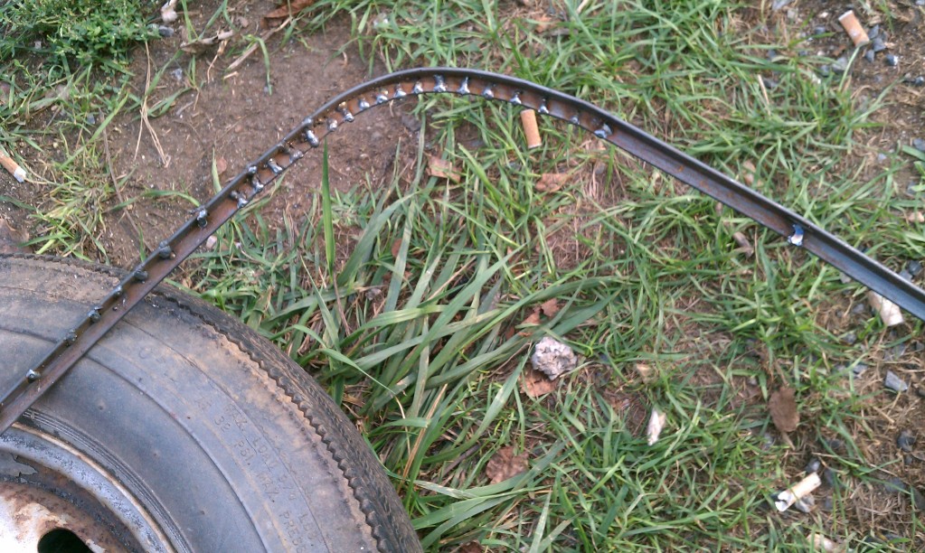

I used 1/2" angle iron to make the new windsheild lip.....lots of cut/ bend/ weld lol
IPB Image
mark21742
After a number of re fittings I added 1" round tube to give the frame some rigidity
IPB Image
mark21742
The frontend before I started getting "cut happy"
IPB Image

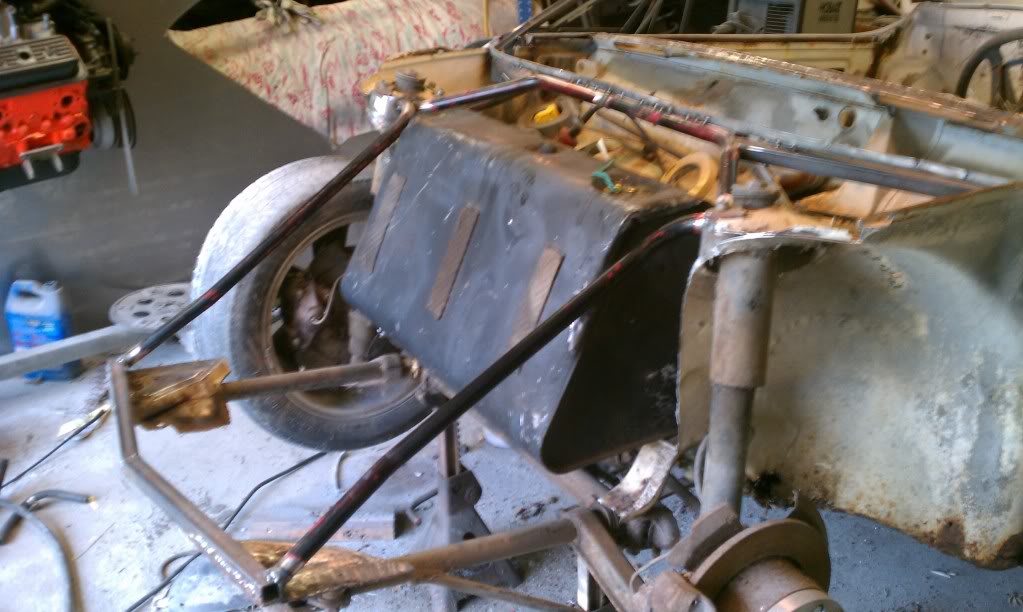

After a lot of cutting and bracing....still need to tie a support from the lower windsheild brace to the front supports
IPB Image
This is where I finished last night and it is sitting now
IPB Image
With the new windsheild sitting so low into the front section I'm going to need to go fuel cell or other gas tank, and extend the dash panel.....I can't wait to get back in the garage and back to work

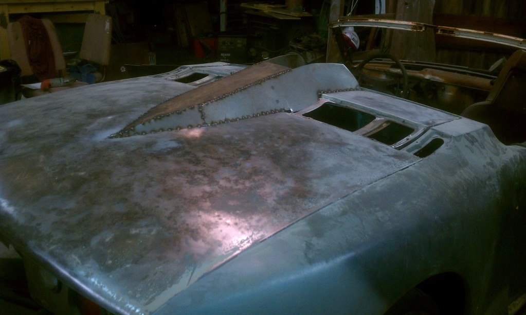

mark21742

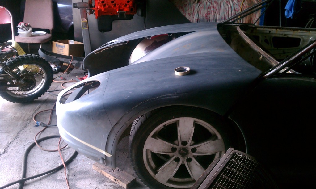

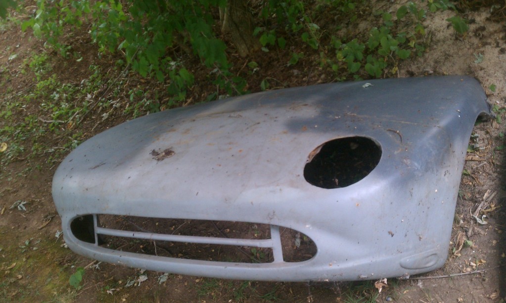

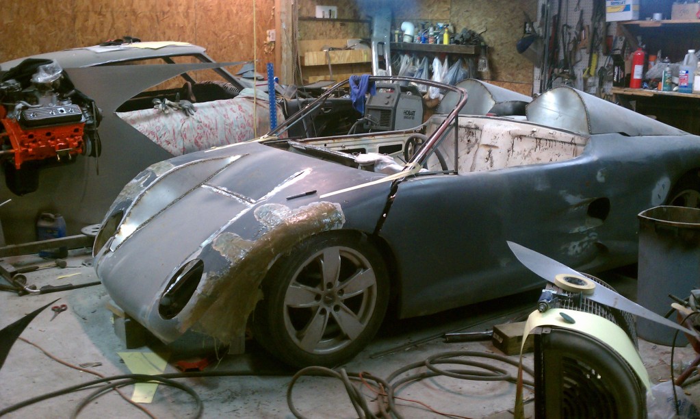

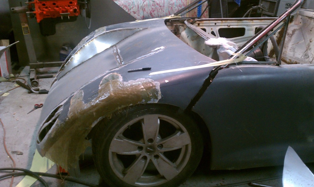

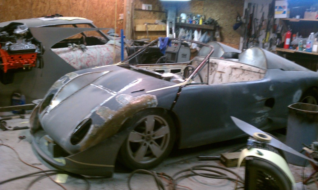

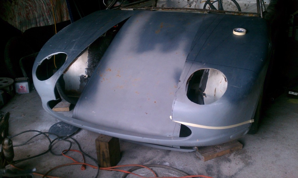

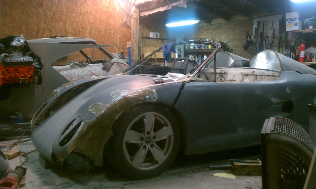

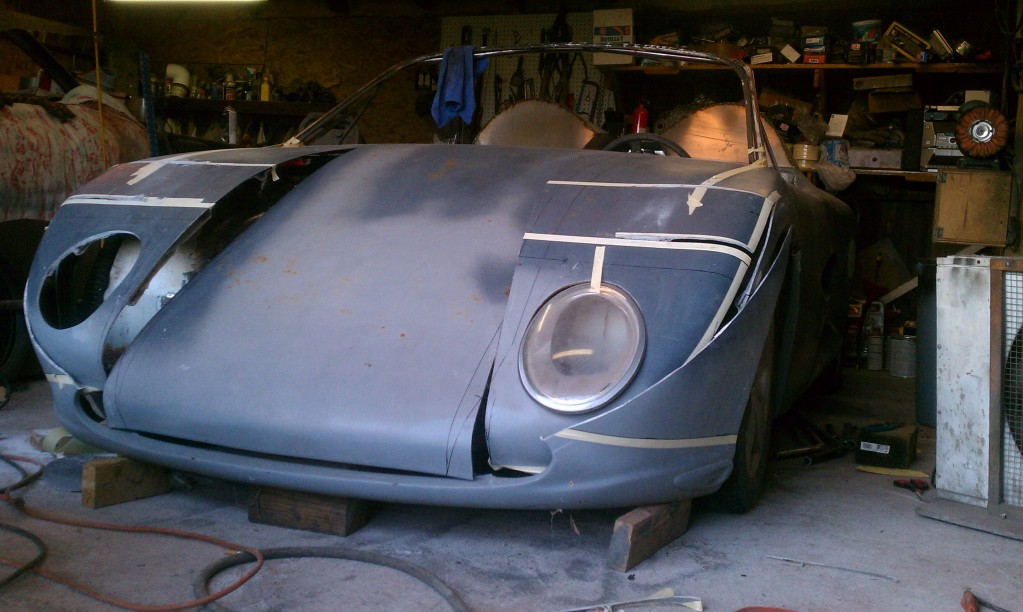

I got to do some cutting on the front clip today! Did some grinding and laid some fiberglass on the fender lips. After the glass sets up over night I'll start working and forming the center of the hood and glass the front edge.
Here are a few more pics, going with new VW Bug headlight lenses and building a double projector light set to fit behind them.
IPB Image
IPB Image
IPB Image
IPB Image
IPB Image
A
Dr Evil
Ok, now that I see what you are doing with the front, and re-curving it, I am hooked smile.gif
mark21742
Yup, the lines of the flatnose kit just didn't flow with the rest of the car.....so I'm gonna cut and hack til it does lol

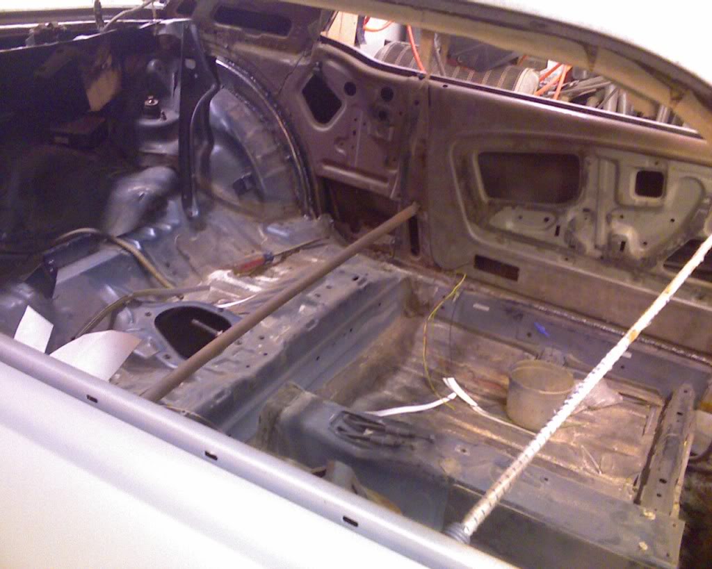

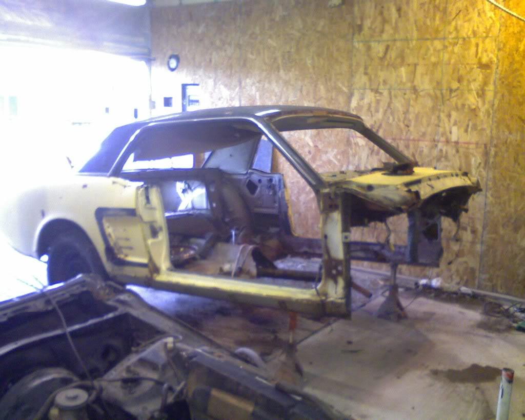

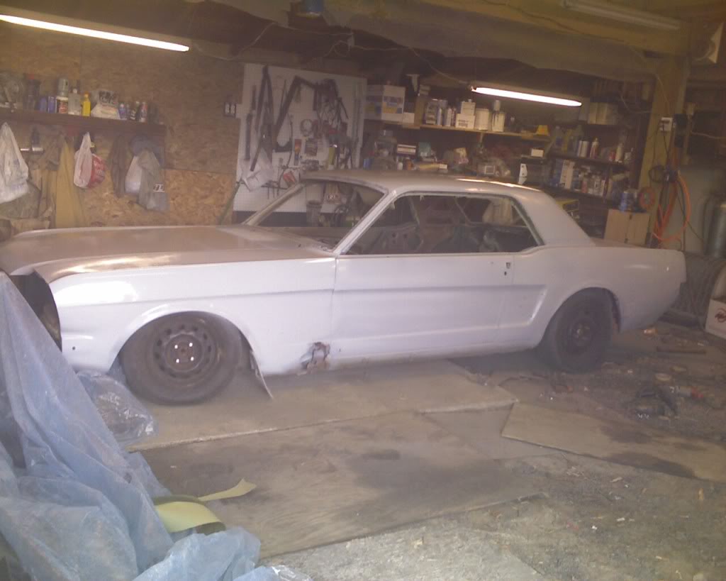

mark21742

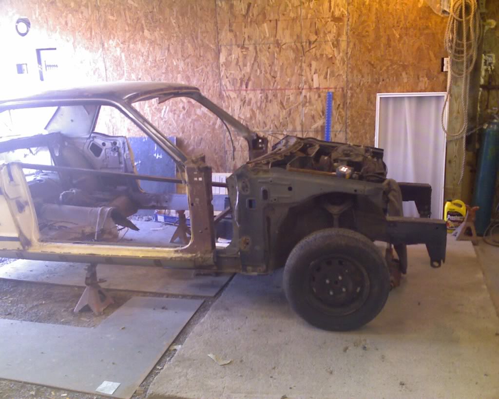

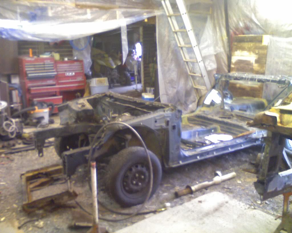

Body/ drivetrain stripped out of the Honda
IPB Image
Stripped down 66 Mustang shell (left the rearend under till the end so I could roll it around like a wheel barrow)
IPB Image
Believe it or not the Honda and the Mustang had the exact same wheel track and only had to stretch the Honda chassis 3" to get the right wheel base....once I cut the outer rockers off the Honda the Mustang inner rockers slid down tight over them and just had to weld the two together smile.gif
IPB Image
IPB Image
IPB Image
Had to play with the adjustable Honda suspension to see what the Mustang looked like slammed, but my mother made me raise it back for her lol
IPB Image

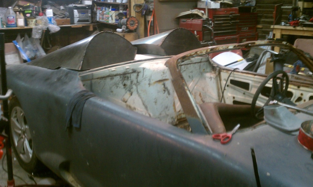

Ok back on the Porsche again lol.
I didn't get as much done yesterday as I wanted to, but managed to get alittle more glass laid and one peice welded back into the hood..... Still need to weld the drivers side peice in, trim and glass the front lip and re shape the windsheild edge of the hood
