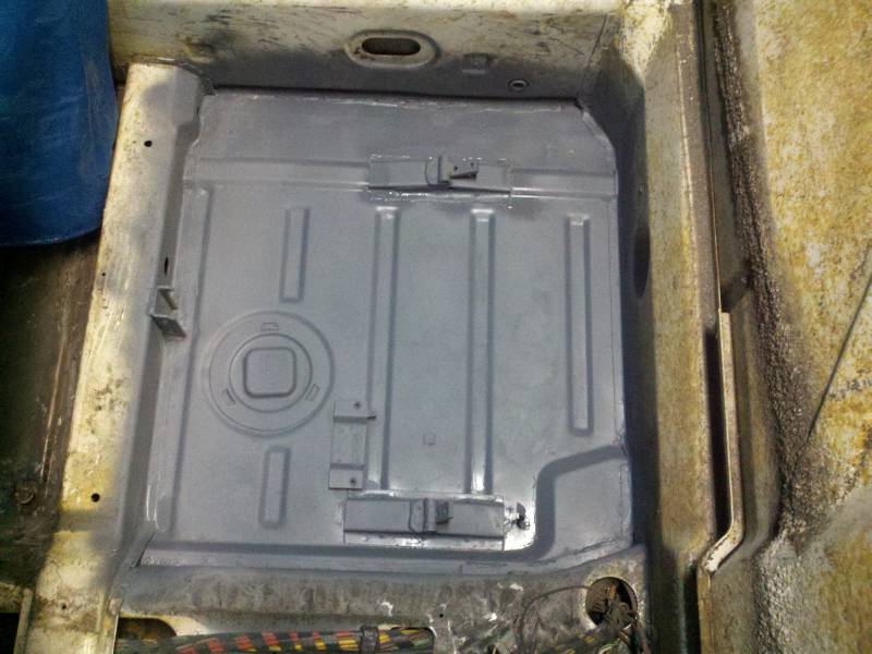

Okay I was pulling my interior to install my new dash & backpad. Down by my seat hinge I see some rust around the hinge mount. It was between the sound deadening factory stuff & the mount. It started around the mount & worked it's way across. I had one tiny hole through & some spots if it hadn't been seen would have gone through. Another gift from my car sitting outside at the wrench who screwed me a while back. He just keeps giving & giving (IMG:style_emoticons/default/headbang.gif) .
So I scraped all the sound deadening off on the rear drivers side pan. I treated it with some rust stuff I have. Tonight I scraped off most the front sound deadening. It was great with the exception of a little more around the pedal. I can tell it is just surface rust but it is coming out. I plan to use bedliner to redo the floor. Then I am going to paint it L80E to match my car.
Here are a few pics to check out of the area mostly scraped up. I haven't started on the passenger side but if it has the same issue I will get some before pics.
What have you used to replace the sound deadening (IMG:style_emoticons/default/confused24.gif)

Spent a little more time last night. Got the passenger side all cleaned up. Did a quick coat of primer just to protect the metal. I also picked up another type of bedliner I am testing out. Looks much smoother than the last one. I'll see how it looks tonight. If it is smooth & the paint bonds well to it. I will use it some. I'm not holding my breath after the last product though.
The primer wasn't dry obviously. Also it is far from done. The front passenger pan is about ready to shoot. I've got a just a little more glue to get off by the foot pad. I've got to tape everything off so I don't get overspray on my car. I also noticed the rear window really didn't seal that great. I am going to pull it & order some butyl tape to reinstall.
