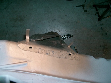

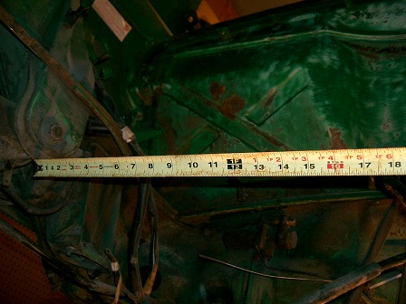

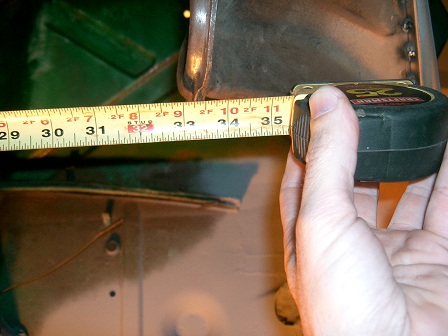

Before finishing all the welding on this piece, I double checked all measurements. Firewall hole to front of inner console hole was still dead on and side to side came in at 33.5".

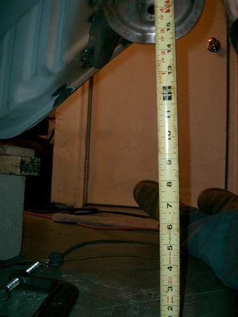

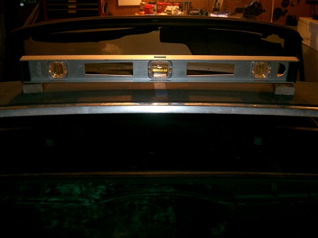

As another sanity check, I leveled the car and took a measurement from the garage floor to the bottom of the ear and checked it against the original drivers side...both were right at 14.25".
There was a slight gap (less than 1/8") at the top of this piece where it forms around the top of the long...reformed with a big hammer while tack welded in place.

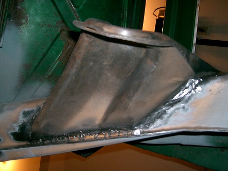

Top edge before adjustment:

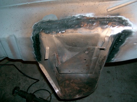

I decided to seam weld this piece on. I am re-using a replacement piece in very good shape installed by the PO. There wasn't enough meat on the some of the edges to drill holes for rosettes. I had to re-use the previous monster rosette holes on the top. I took my time and cooled the area with compressed air after every few welds. The roughest part was welding the bottom area near the seam where the inner and outer long meet upside down. (IMG:style_emoticons/default/welder.gif)
