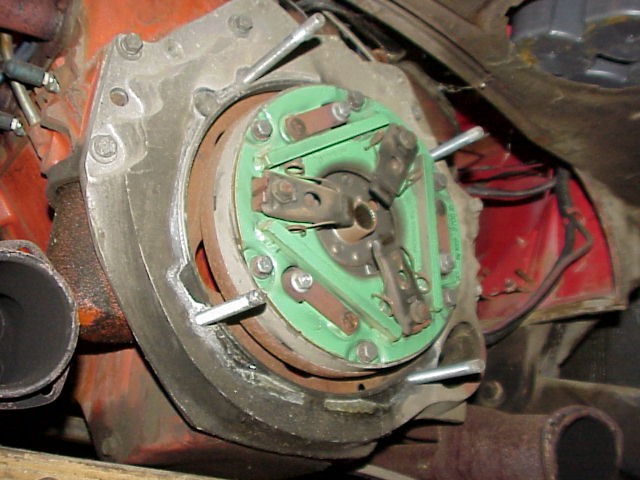

Here's a pic at Brad's. He said it was the only good thing about the Jaide conversion. I have the basic kit. The 915 bellhousing adapter was cast much deeper for the intermediate shaft. I'll have to scan those from the brochure...
