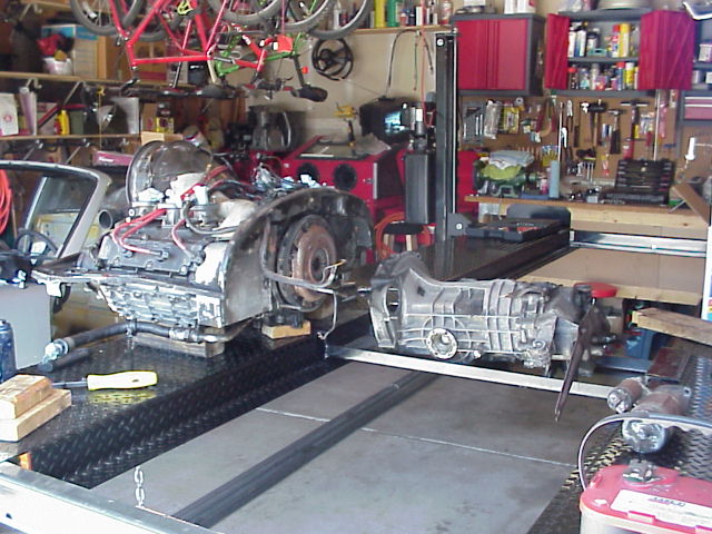

Post engine/trans removal. That's the donor-mobile in the background.

Gint   Post engine/trans removal. That's the donor-m...   Apr 15 2003, 09:32 PM
