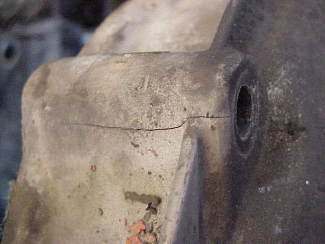

This could be a problem. Right side upper bolt hole. Can you weld these cases?

krk   Mike, Post a pic. (I'm not quite sure from yo...   Apr 14 2003, 07:29 PM

Brad Roberts   Mike. I dont want to steal Kims pics... but I hav...   Apr 14 2003, 08:15 PM
krk   Brad, Steal away dude! I'd have to go out...   Apr 14 2003, 08:18 PM
Gint   I don't think Kim or I will care Brad. I...   Apr 14 2003, 08:22 PM
Brad Roberts   Mike, what the shops normally do: they cut away t...   Apr 14 2003, 08:25 PM
Gint   That's the description I was trying to come up...   Apr 14 2003, 08:29 PM
Brad Roberts   Shoot a pic when you can. I cant imagine a shop fr...   Apr 14 2003, 08:42 PM
