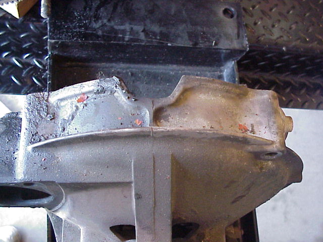

Gint   Got the engine on the stand today. 2 liters (2.2?...   Apr 19 2003, 10:49 PM
Gint   The $60 ebay engine stand bracket set I bough...   Apr 19 2003, 10:51 PM
