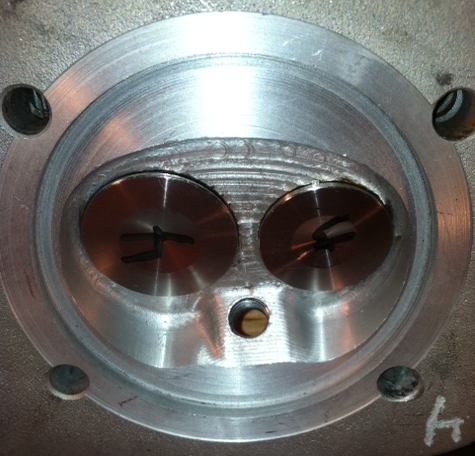

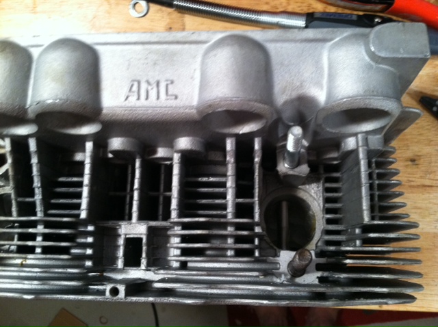

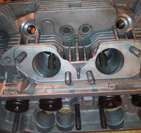

Here are some pics of my Bugpatch Heads-

They say 'a picture is worth a 1000 words'.... what did they use? A dremel tool? WOW.....
This is one of the problems with this website- nobody is interested in seeing any alternative to certain shops. Nobody questions that lens are the best however the price is often out of the range that most want to spend. For example, I am simply having fun building my engine. I plan on using it for rare street use so spending +2500 on heads isn't a great idea. I posted the pics so that others in similar situations can see the alternatives. I realize that they are not of the caliber of Lens heads however nobody claimed they were.
The original topic of this thread was DRD heads. Nobody has owned up to owning and set and posted pics- probably because they will catch a bunch of crap if they do.
Also- for the record- the marks in the chambers are from the CNC machine and are barely palpable.

904svo   Those heads look like AMC heads from Spain.   Apr 4 2010, 09:26 AM

914werke   is it just the picture or are the EX ports on thos...   Nov 14 2011, 07:15 PM
tornik550   is it just the picture or are the EX ports on tho...   Nov 14 2011, 07:47 PM
Speedster Mike   is it just the picture or are the EX ports on th...   Nov 15 2011, 12:52 PM
