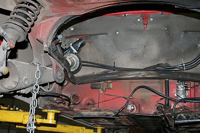

I installed mine on the firewall. See photo. Solved my vapor lock problems.

QUOTE(JawjaPorsche @ Nov 16 2011, 07:31 PM) *
I put mine in this same exact location away from the HE's. Works fine and I have run the car in 100 plus temps...no problems.
