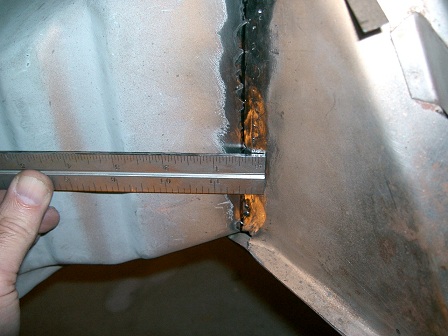

Finally got my new inner long welded in with doubler plates on all seams. Verified the incline of the new long with an incline gauge (with the car level) following Jeff Hails build thread. Door operates well! Entire inner long has been coated with rust encapsulator.

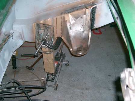

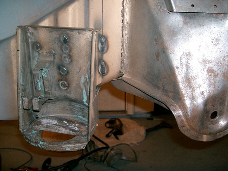

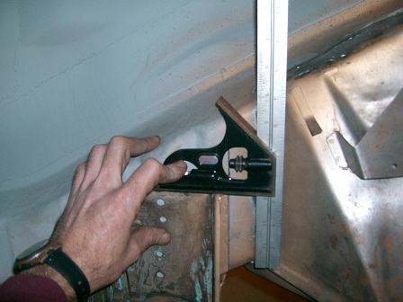

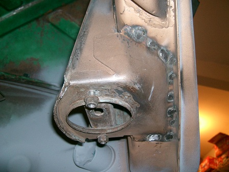

Indexing the right engine bar mount took some time. I had saved the original chunk of long I removed the mount from, so I re-aligned the holes and took a measurement from the edge of the inner suspension console to the edge of the mount and came up with 1 3/8". The suspension console that I welded in was aftermarket and did not have as much meat on the edges as the factory piece. I measured off the start of the bend of the installed console and marked a line on the long to match the factory edge. Up & down was verified at 3 5/16" (taken from the original long) with a combination square from the top of the mount to the top of the edge of the suspension console.

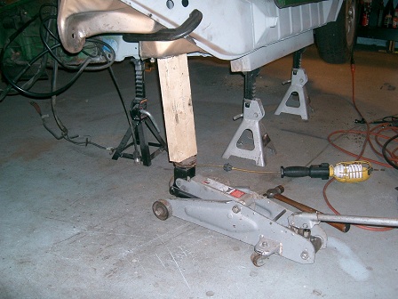

Used a big C clamp & jack to hold it in position for welding and verified all measurements one more time:
Re-filled the factory rosettes and seam welded a few 1" or so sections on both sides.
